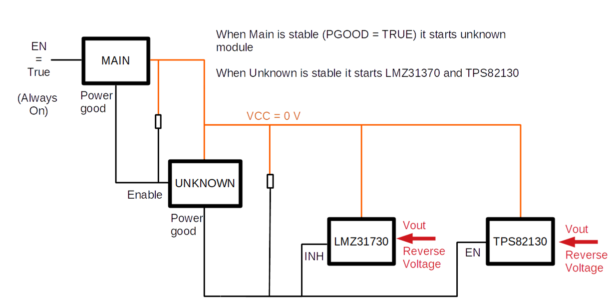

    We have a connection between two devices and one could be without power whilst the other is transmitting data.
    This would then propagate to the power supply, but I guess it causes no damage due to the low current.
    The INH/EN pins of these smps (TPS82130/LMZ31710) are only held low by the power good output of the previous powersupply stage.
    I don't have the schematic of that previous stage and there is no additional resistor to pull it down.
    The Powergood is connected via a 10k pullup to the output of the main power supply, but i might add a large resistance pull-down to improve on this without disturbing normal operation.
    Maybe this is better than my description.
  • Hi Johann, the LMZ31710 and TPS82130 may remain disabled anyway due to their UVLO. The 3.3V reverse conducting to VCC will be a diode drop lower or around 2.6-2.7V, which appears to be below the UVLO rising thresholds of these devices.
    You may want to see (experimentally) what is the minimum supply voltage that turns on the Unknown power stage since it will see the 2.6-2.7V at its supply terminal according to your diagram.
