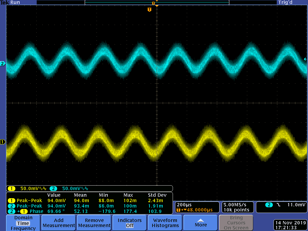

    I found the point of where the voltage on the sides of the test resistor was a function of load.
    Load Unity Gain Frequency
    0 20.5Hz
    15mA 810Hz
    30mA 1,403Hz
    1.5A 4,080Hz
    Waveforms with 1.5A load:
    Across all frequencies and all loads, the AC voltage on the output lagged the voltage on the other side of the test resistor by around 30 degrees.  It's hard to estimate the amount of phase difference, but that's what I got comparing the time between peaks to the period.
    Does this sound normal?
  • Charles,
    Yes this sounds normal.
    -Sam

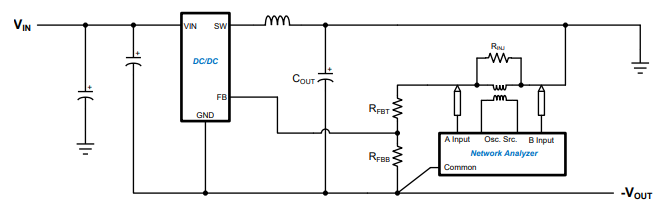

    How would I do this same test on an LM46002 in the inverting mode?
    My board has an LM46002 configured for +15V and -15V.  Here is the schematic for -15V.  The purple arrow shows where I broke the loop and added 33 ohm resistor.
    The trouble is the amplitudes are the same (unity gain) across various frequencies and loads, unlike the tests I did on the +15V supply.  Am I breaking the loop in the wrong place?
  • Charles,
    Break the loop on the top feedback network like in the non-inverting test.
    -Sam
    In inverting mode the top of the feedback network is ground.  (This Figure 1 from the Inverting Applications App Note.)
    The procedure calls for measuring the signal referenced to ground.
  • Charles,
    Please refer to the app note SNVA856, figure 6.
    -Sam
    I see, I need to float the scope and measure the signals referenced to the negative supply output.
