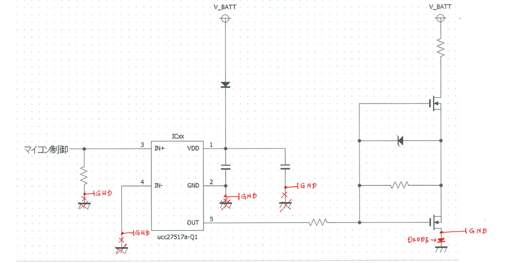

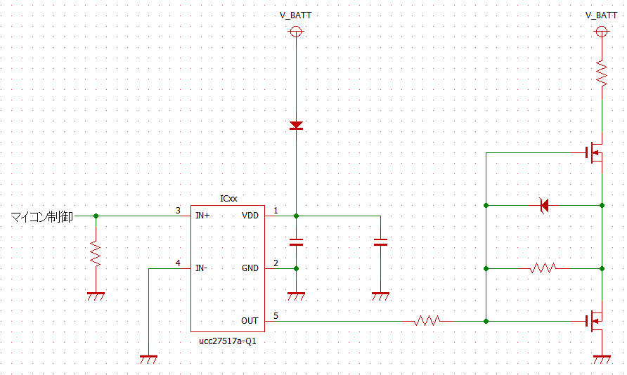

    Below is the rough schematic for UCC27517A-Q1. The component values are not decided.
    Under reverse battery condition, V_BATT will be connected to - of battery & GND will be
    connected to + of battery. The battery voltage will be typ. 12V, + to -.

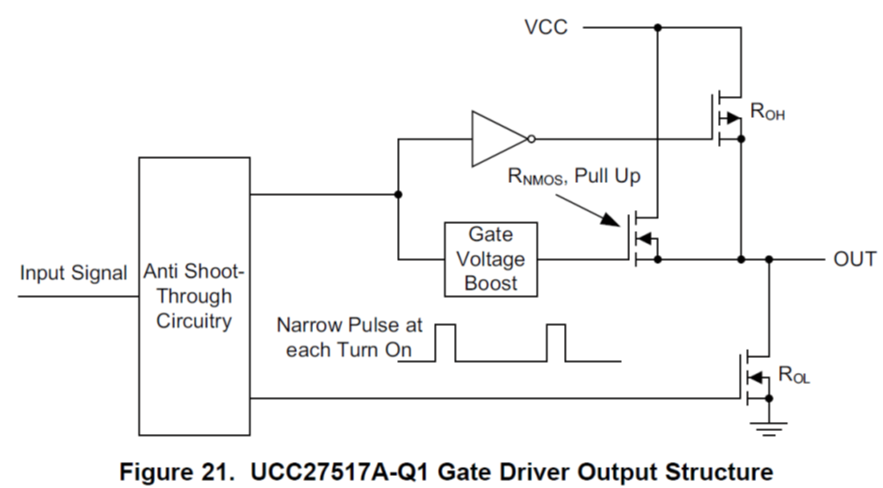

    The customer is concerning if ROL FET has the body diode, the current flow to OUT pin would be
    happened.
    Could you please check and give your advice for us.
    H. Sakai

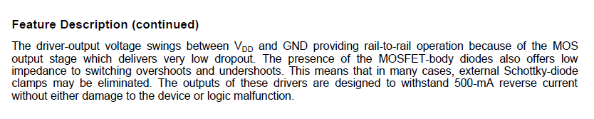

    Regarding my previous question about the body diode on ROL.
    There will be the body diode on ROL according the datasheet description.
    I also checked the simulation model. I could see the leakage due to the body diode.

    1. Put the diode between the bottom side external FET and GND.
    2. All IC's GND will be connected to the Anode of diode.
       IC's GND voltage will be elevated to VF of the diode.
    Is it no problem taking this kind of usage?
    Please give your advice.
    H. Sakai

    You're correct the N-ch FET does have a body diode which generally helps in undershoot conditions as mentioned in the d/s.

    From the driver's perspective, the diode between IC and GND seems reasonable to address customer previous issues but I would caution that the IN+ signal will then be referenced to a slightly lower potential as IN+ will be at 0V while driver IC is at ~0.7V. I suggest to account for the IN+ signal amplitude and the driver's VIH and VIL thresholds. You might consider a discrete pnp level-shifter between IN+ signal and driver's IN+ pin to overcome this difference in potential.
