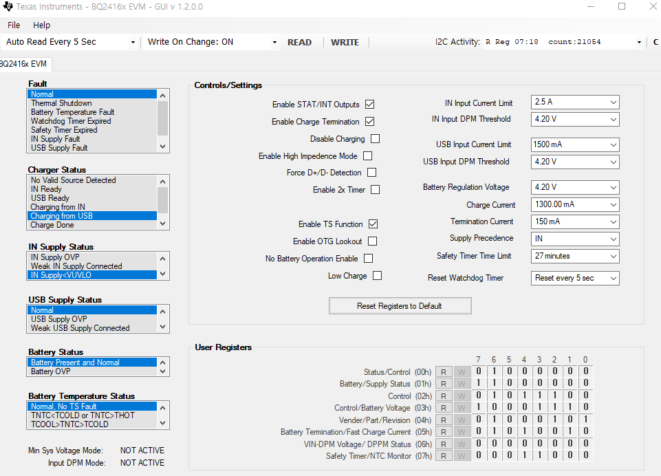

I set the power supply as 5V (I_limit 3.75A) and connected to USB input.
I connected Li-Po battery to proper port and set the program as below.
I can see that the 'Charger status' indicate 'Charging from USB'.
I checked the TS pin voltage and it it 2.48V.
But the power supply shows only 7mA!
Battery is not charged whatever I changed the options of program.
7mA is actually used for LED indication. (Power supply shows 0mA if I turn off 'Enable STAT/INT Outputs'.)
What should I do for the charging??
What did I missed?
Please help me to solve the problem.
