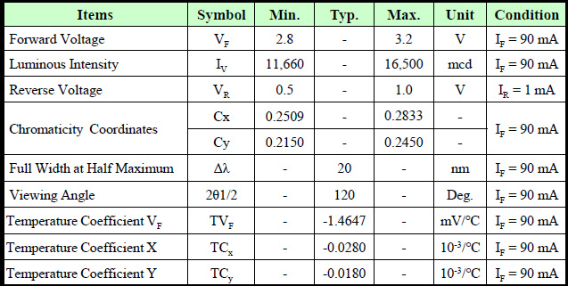

-. TPS92610-Q1 can be used for TFT LCD backlight?
-. For below configuration with TFT LCD(800 x 90), can TPS92610-Q1 support fine dimming control without brighteness issue and etc?
Sam Lee
  • Hi Lee
    Could you offer the detail about the project, like the LED's parameter, the dimming ruquest and the diagnostic quest.
  • Hi Frank,
    There is not detailed spec yet. When assuming that general LEDs are used, can the dimming control be achieved well through TPS92610-Q1?
    Fyi, they had experience for 6 series x 2 strings (272x280) with TPS92610-Q1, but at this time they're trying to change the configuration into 3 series x 4strings with different resolution (800x90).
    Do you think that it'll be okay?
    Sam Lee
  • Hi Frank,
    A customer is waiting for your answer to make the next progress. Can you get me your feedback about if TPS92610-Q1 is available for the 4 strings x 3series (6", 800x90)? The max. output current at TPS92610-Q1 will be under 200mA.
    If TPS92610-Q1 is not a proper device, can you recommend other driver for the application?
    Please refer to LED spec below.
    Sam Lee
  • Hi Lee,
    I have some question about this project:
    1)As you say the max output current of TPS92610 is 200mA, so the forward current of each string is about 50mA.I must know the Vf of LED @50mA and the input voltage, then I can judge whether it can satisfy the thermel feature.
    2)Do you customer have dimming require because TPS92610 is defined for rear lamp, so I am not sure whether it suit or not.
    3)Could you offer the customer's information, and the detail of the project.
    You can send e-mail to me , I think it's a more efficient way to communicate and good for customer's privacy.
