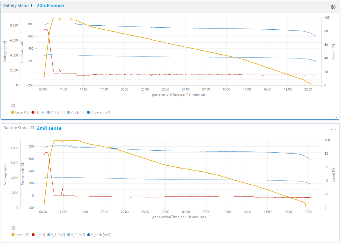

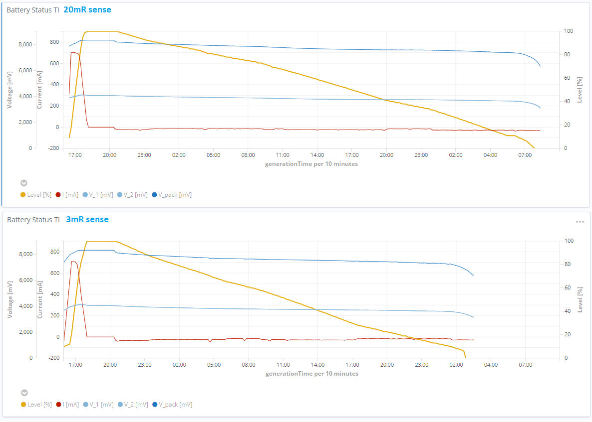

  • Hello Onyx,
    Thanks for your fast reply. Perhaps I should be more precise with my numbers :
    Average discharge current is 10-30mA.
    We have short pulsed currents in the 200-300mA range (max discharge current reported in lifetimes) and at other moments (MCU sleep) we use only 2-3mA.
    I did more testings with two pairs of same devices, one modified with 20mR sense resistor and the other with 3mR standard.
    I have better results with 20mR. With 3mR in most of the cases at the end I have a drop from 3%/8%  to 0% of RSoC. Some graphs below.
    It seems with the 3mR resistor the gauge miss some current at discharge, do you think we can use 20mR sense resistor for BQ40z50 ?
  • Hi, Emilien
        Using a sense resistor with higher value always yields higher accuracy current reading, and this will also improve the SOC accuracy. The main concern of using a 20mOhm Resistor is for your system noise rejection, if your system is not sensitive to the noise caused by using higher value resistor, then a 20mOhm value should be OK from gauge side.
