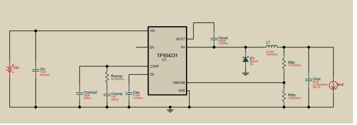

Please help check the schematic of TPS54331. Vin=5V, Vout1=3V3, Vout2=1V2. For now, no 3V3 and 1V2 in the output. Thanks.
This is used to power the F28377D DSP.

L8 and L9 are too large, It would be better to select 2.2uH.
And R17 and R23 are also too large, you can use Webench to optimize the compensation values.

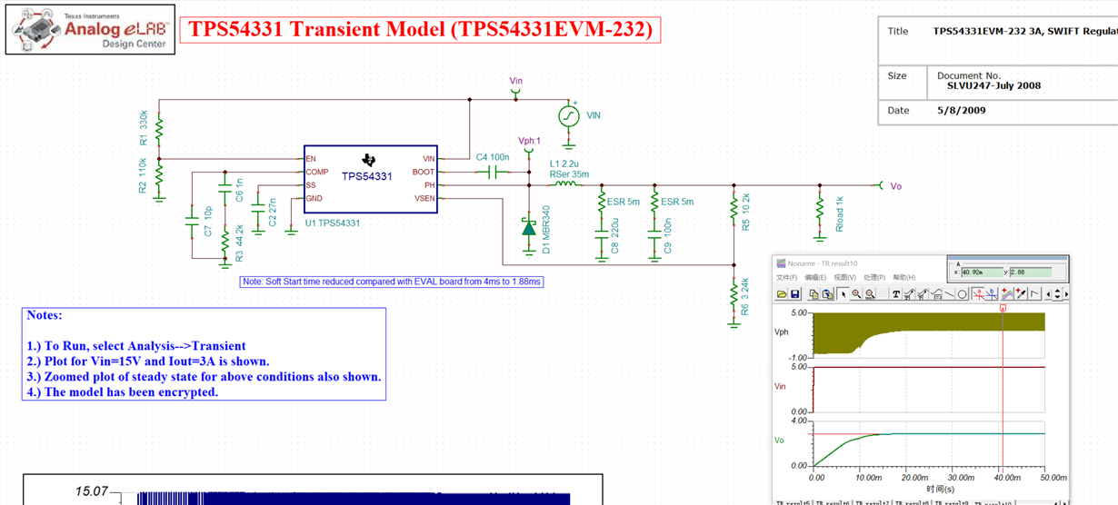

You set soft start capacitor 27nF, that is why the soft start time is long.
And for the output voltage, I think it is measurement error, you can zoom in the waveform and double check it.
Shawn
I have tried to adjust the value of the soft-start capacitor, the soft-start time is shorter.
But the output voltage did not make changes.
I don't quite understand where the problem is.
