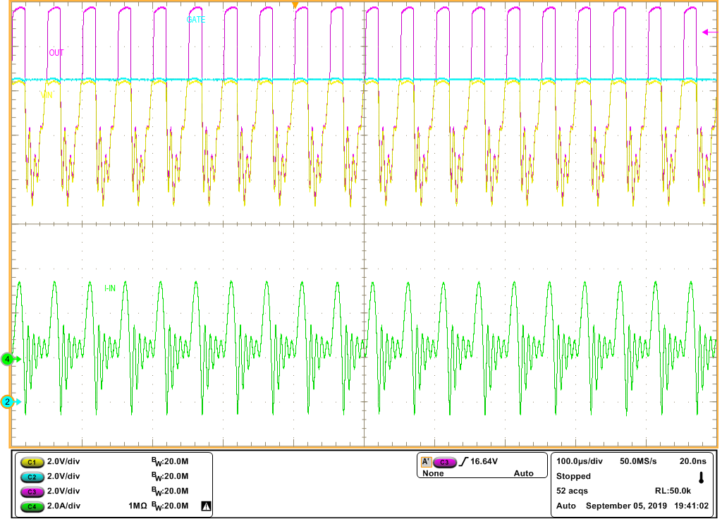

Hi team,
I want to use LM74610-Q1 for Oring application (3.3V) , but i have concern about the reverse current during one of the LM74610's input voltage drops , because Oring's input are buck converter  not battery .
I'm worried about the reverse current damage input buck converter during LM74610 turn off the external MOSFET  (TRECOVERY)
