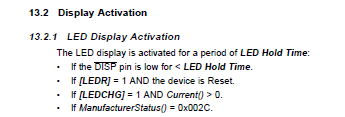

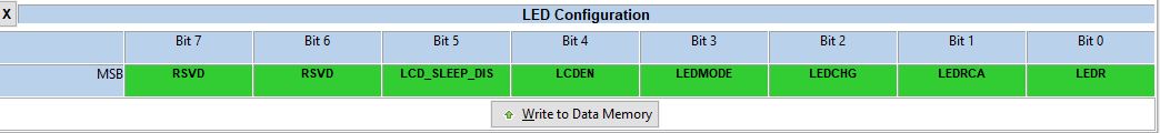

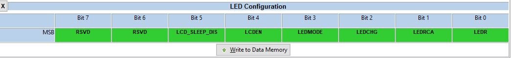

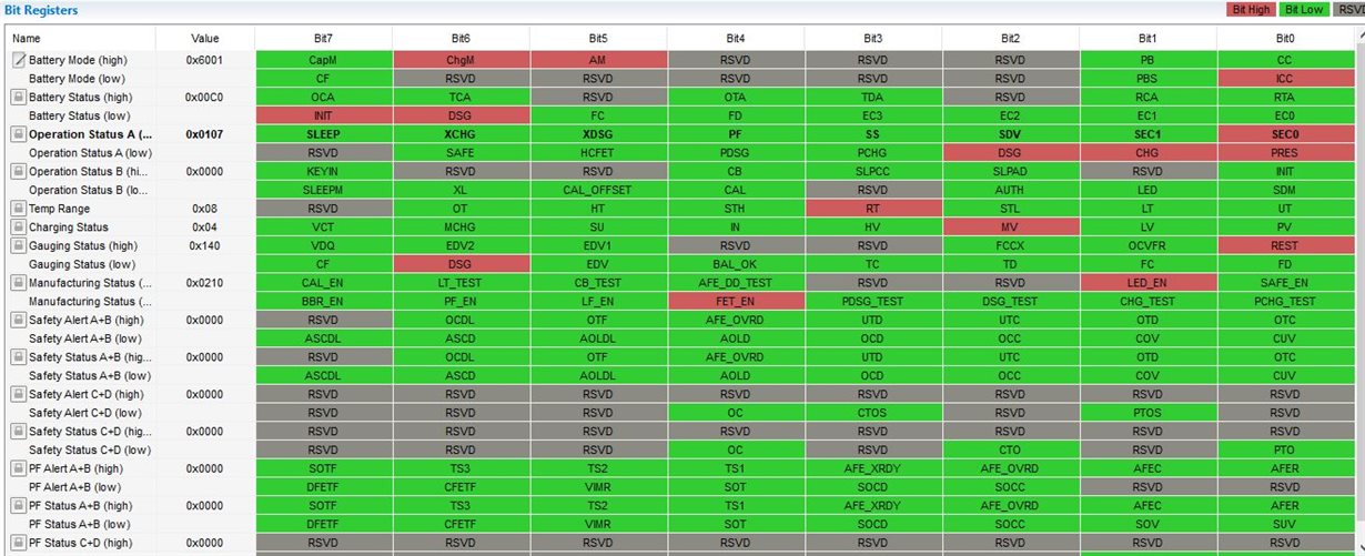

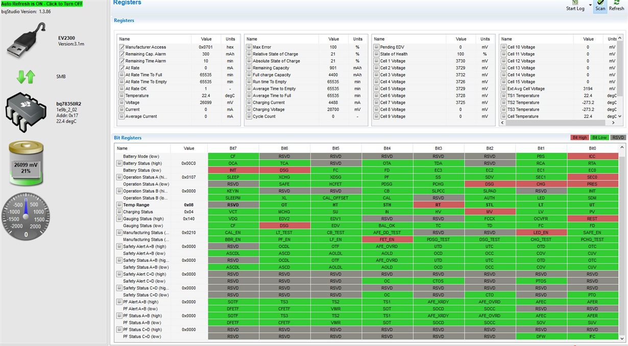

My LED SOC indicator on battery pack doesnt work. I think the issue is on registers because when I send LED_Toggle command, all leds turn on.
Also first time I soldered LED's and button, it was working well. But after some changes on gg file, I cant use leds. Could you help me about registers to use leds ? What kind of registers should I re/set for leds?
By the way there is no fault status.
