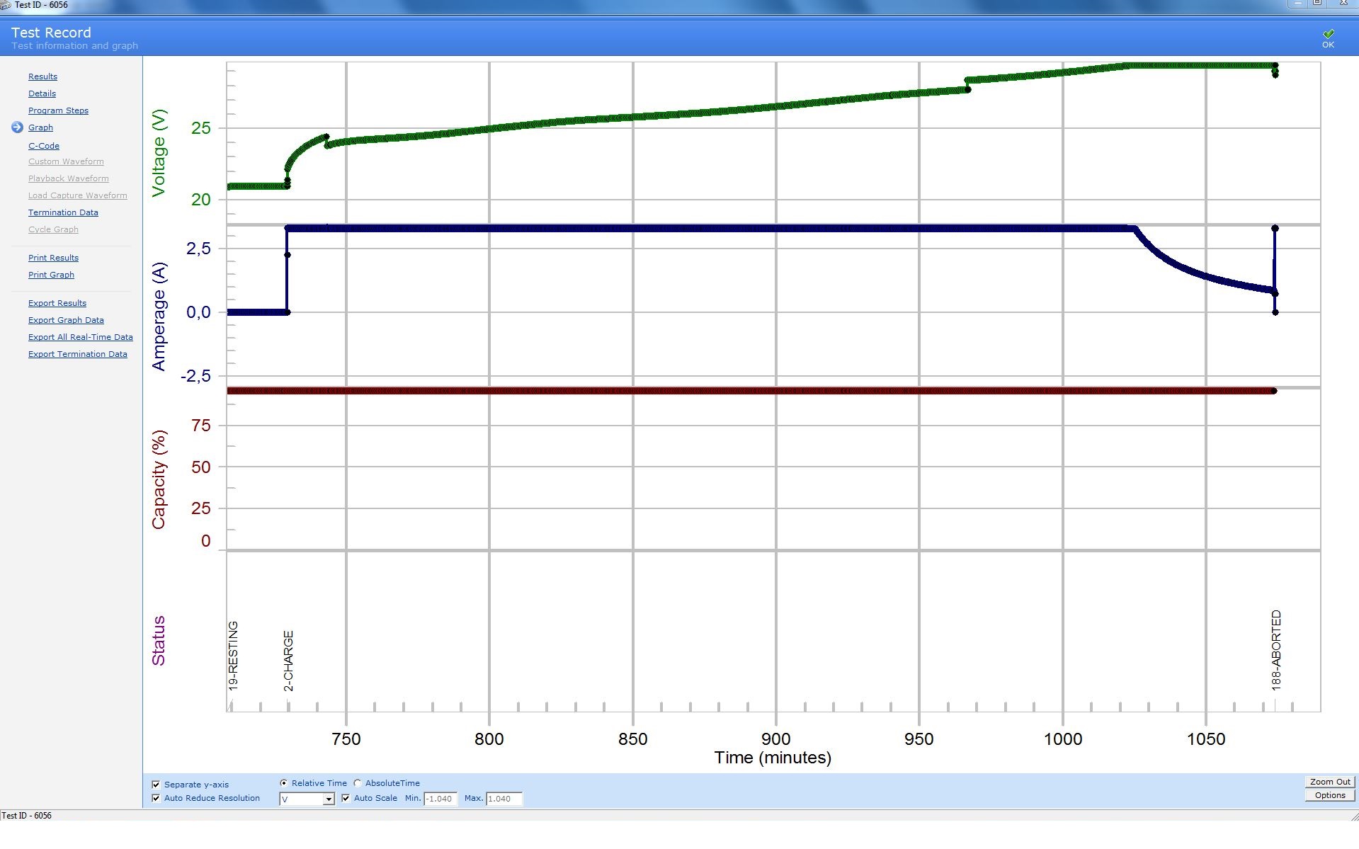

I am trying to get a successful learning cycle with 7 cells in series and high capacity.
During a charge the CUVC flag occurs and the DSG Mosfet opens.
You can see it in the picture below where is a voltage drop/jump.
After disabling it I am still not able to reach an update status which is higher than 0x05.
Is this a normal behavior?
