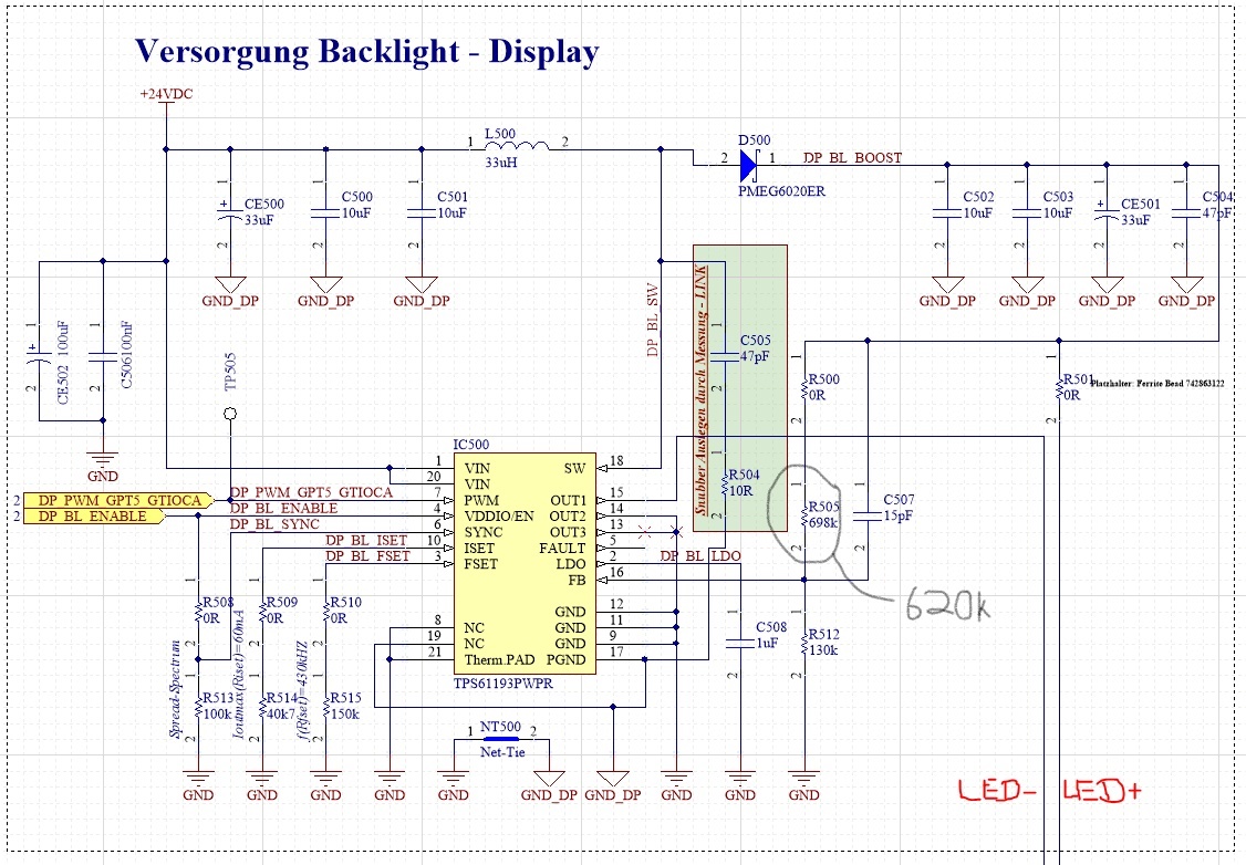

i have a problem with my custom pcb, using the TPS61193 for a backlight of a display.

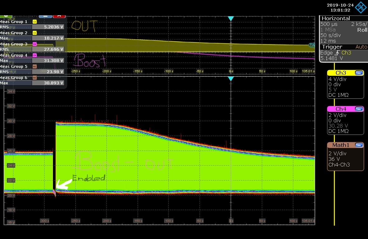

Powering the PCB, the controller starts PWM and enables the TPS-Driver. Then my Display starts to show me a picture with a good brightness but after a 4-5 minutes, the TPS-Driver has dimmed the brightness and the Display looks way to dark.
I´m using a Display with Vf = 27.9V; Imax=60mA. It has one LED-String on Vout1. Vout2 and Vout3 are tied to GND, since they are not used.
I tryed different resistorvalues for the feedbackloop (R505) - but no differences. It looks like the Vout1 Voltage get´s above MID_COMP and so the TPS-Driver is adjusting downwards.
Maybe you can take a look on my schematic. I also added a screenshot of the Vout1, VBoost and the V(VBoost-Vout1) Voltage.

  • Hi Max,
        So commons as below:
        1. R505 should be set about 700kohm, 620kohm is a little low;
         2. Have you checked the fault pin, is there any signal change when you observed that the output voltage drop and brightness change?
        3. Is this a thermal issue?
         4. Schematic seems ok.
    Sean

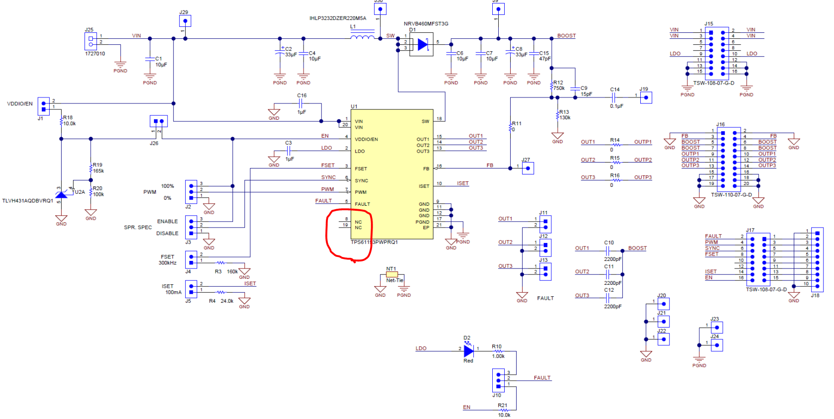

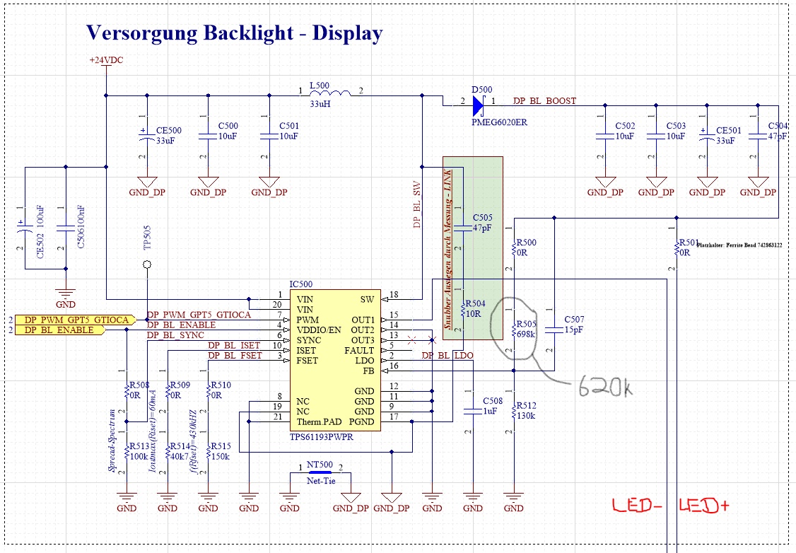

    I think i finally found the mistake. As you can see in the schematic, i connedted Pin 8 and Pin 19 to GND but in the Datasheet it says they´re NC-Pins. After cutting the legs of these two pins, my voltage keeps constant.
    Can you tell me something about these two Pins? Do they have some kind of hidden function or influences to the Driver?
    thank you
    Max

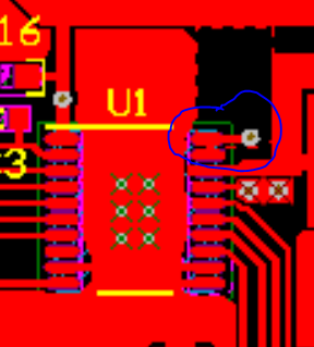

  • One more: I ordered the Eval-Board of the TPS61193 and there is Pin 19 tied to VIN. Why?
  • Hi Max,
        I have checked TPS61193EVM schematic, P19 is not connected to Vin as below:
    Sean
  • Hi Sean,
    I thought the pin is connected to pin 20 in the PCB, but that's probably because of the dotted line.
    Thank you,
    Max
  • Hi Max,
        Don't worry about this pin, for your design, you need just float this pin.
    Sean
