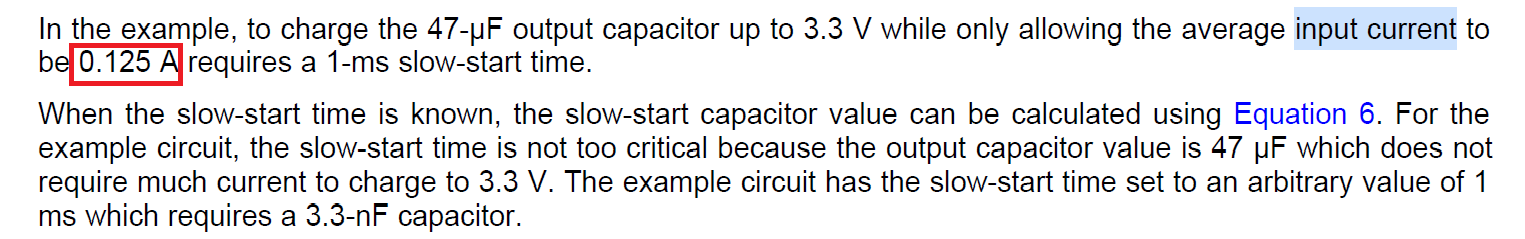

There are two questions about TPS54140 soft star. Could you help on this inquiry! Very  thanks.
1. In the 9.2.2.6, it says the avg. input current to be 0.125A. Where does this current come from?

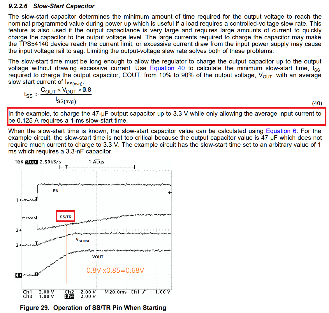

2. What period is for the soft start time from below waveform Figure 29?
