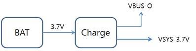

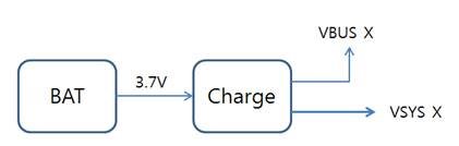

The problem occurred in my customer's set with BQ25890.
In case 1 below, it is normal, but in case 2, Vsys does not come on.
1. When charging, VSYS powers on.
2. If not charging, BAT power is present but VSYS power is not.
When connecting the charger and removing the charger while running Set, the VSYS power is turned off immediately.
If you check the symptoms, it works as if it is disabled even though the battery is connected.

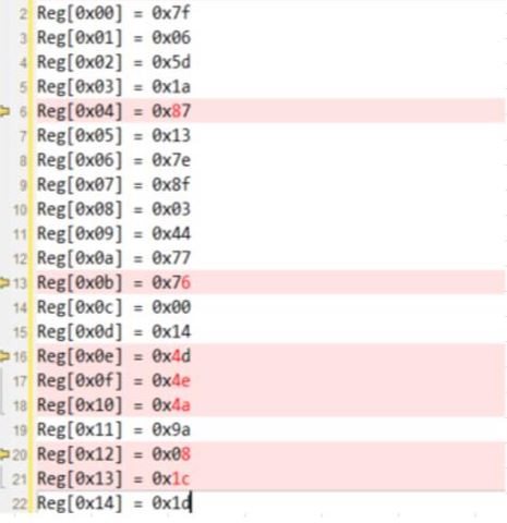

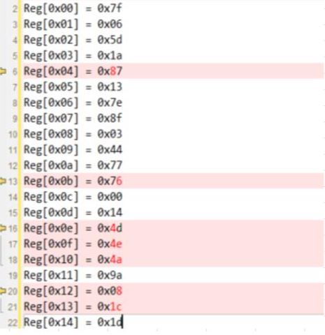

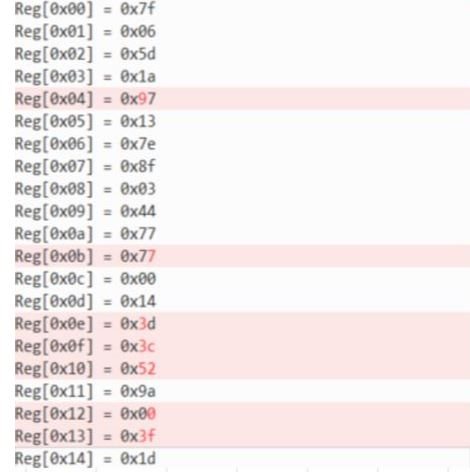

The following is the BQ25890 register when the problem occurs with reference.
Reg[0x00] = 0x5c
Reg[0x01] = 0x06
Reg[0x02] = 0x5d
Reg[0x03] = 0x1a
Reg[0x04] = 0x9c
Reg[0x05] = 0x13
Reg[0x06] = 0x7e
Reg[0x07] = 0x8f
Reg[0x08] = 0x03
Reg[0x09] = 0x4c
Reg[0x0a] = 0x77
Reg[0x0b] = 0x86
Reg[0x0c] = 0x00
Reg[0x0d] = 0x55
Reg[0x0e] = 0x4a
Reg[0x0f] = 0x4d
Reg[0x10] = 0x58
Reg[0x11] = 0xe1
Reg[0x12] = 0x00
Reg[0x13] = 0x0b
Reg[0x14] = 0x1d
REG09 [5] Try BATFET_DIS = 1-> 0 and force BATFET off-> on
REG14 [7] I tried Register Reset with REG_RST = 1, but the problem is still not solved.
