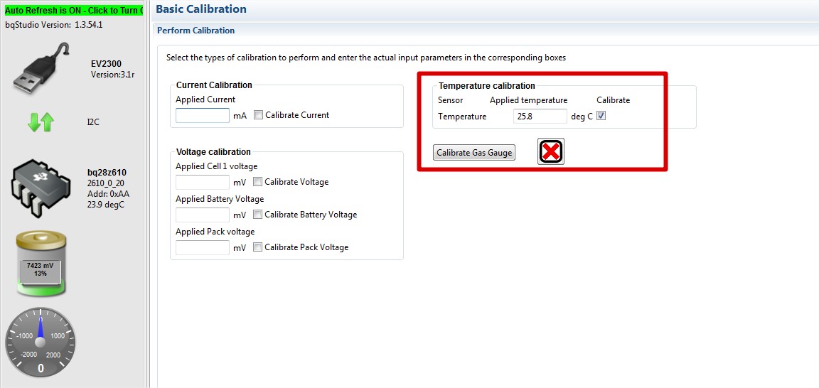

I tried to calibrate internal temperature sensor with EV2300, but it doesn't work as below picture.
May i know why can't temperature calibration for internal sensor?

Hi Onyx,
I already solved this problem because I used old bqstidop version (V1.3.54) cause internal temperature calibration doesn't work.
Right now I used V1.3.86 temperature calibration that it work.
