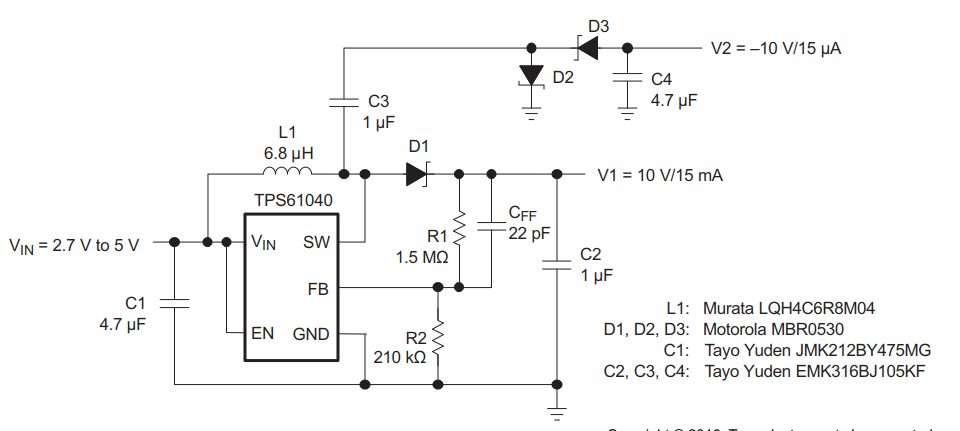

TPS61041: high current on both the rails required? how to calculate the required parameter values.
Part Number: TPS61041
Other Parts Discussed in Thread: TPS61040, LM5155,
Dear friends,
I need a positive 24V with an output current of 400mA and a negative 24V with an output current of 400mA. what are the parameters to take care of for high current requirement?
Also, I referred to the below design for the Dual output boost converter. from the data sheet, but the negative output is a unregulated output.
Please suggest a design solution for my requirement.
