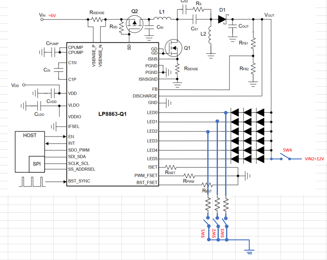

LP8863-Q1: How to use LP8863
Part Number: LP8863-Q1
VIN = 6V, VIN2 = 12V
When EN pin is Lo, SW1-4 is closed and VIN2 = 12V is supplied to the LED for driving.
When the EN pin is Hi, SW1-4 is opened and Vout is supplied to the LED for driving.
Can it be used as described above?
Is the LED0-LED5 output in the Hi-Z state when the current of LED0-LED5 is set to 0mA while the EN pin is HI?
