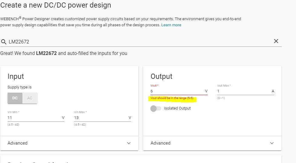

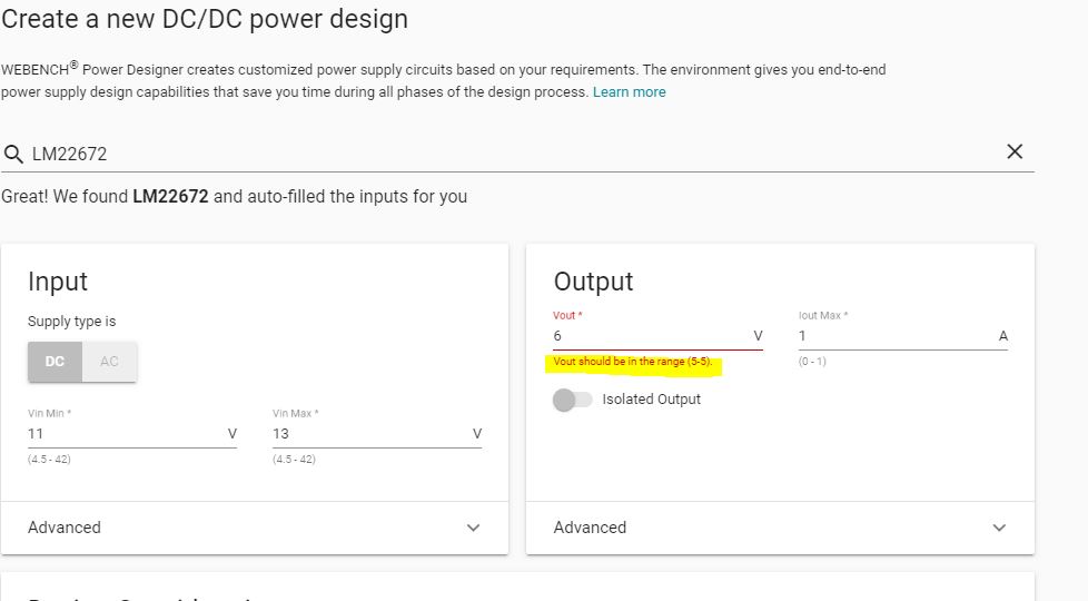

Hi folks !

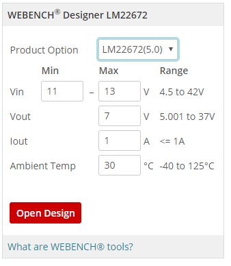

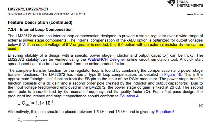

I'm designing new prototype and needs to generate a 6V supply from 12V. I've selected the LM22672 since it's very common at my distributor and the switching frequency can be adjusted. The datasheets :
However, when going into webench design tool, it's a no-go to have a voltage above 5V :
Is there any reason this chip should not be used to generate voltages above 5V ? If not, you guys have an alternative ? I need 6V (ADJ, not fixed, may have to go a bit above or below) output, at least 800mA output current and adjustable frequency.
