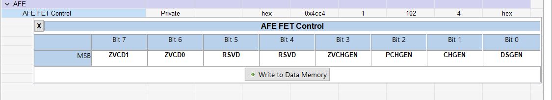

I know that the DSG and CHG FETs can be individually controlled, but only through I2C commands and only when the Firmware FET control is disabled..
So I am at a loss.  The function that I am looking for should be technically possible.  There must be a way for me to manually command the DSG FET ON or OFF.  Preferably through one of the GPIO pins.   Any help with this would be hugely appreciated.  It's the last design obstacle in this project.
