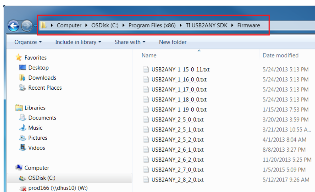

    When I use the USB2ANY Explorer.exe or USB2ANY Firmware Loader.exe the alternate firmware version does not appear in the dropdown list. I placed the alternate firmware file in the C:\Program Files (x86)\Texas Instruments\USB2ANY Explorer\Bin\Firmware and have tried placing it in "C:\Users\mjn\Documents\tmp"
    When I specify the filename with a path in the dropdown box I get the message "ready to update firmware to version 255.255.255.255" . I've also tried specifying the filename without a path and I've tried specifying the file without the .txt file extension.
  • Hi, Mark
    You can try to place file(USB2ANY_1_19_0_0.txt) to below directory, then restart computer to check if it is showed in dropdown list. (USB2ANY Firmware Loader.exe)
  • there is a difference in the directory tree from what I have installed and what you have listed.
    I notice your installation is for the USB2Any SDK (software development kit). This is part of the issue. I'm guessing your developer only tests the software on a development machine.
    The revision number I have for both the non-SDK installation and the SDK installation are the same at 2.8.2.0 although I suspect they are a different code base.
    I managed to get the dropdown populated with the downgraded firmware image.
    1. Uninstall any previous versions of USB2ANY Explorer software
    2. Install the full SDK version of the USB2ANY software. Unfortunately I cant locate where I found the SDK installation. Please provide the link to it.
    3. Place the USB2ANY_1_19_0_0.txt file in the firmware folder
    4. Run the USB2ANY Firmware Loader.exe (do not use the USB2ANY Explorer.exe and the advanced button within it. This doesn't work)
    5. For me the USB2ANY_1_19_0_0.txt then showed up in the dropdown list. (Note that although text can be entered in the dropdown list, specifying the file to use does not work)

    2. The default SDK installation directory in my computer is C:\Program Files (x86)\TI USB2ANY SDK\
    I take a summary for workaround, see the attached.
    You should place the USB2ANY_1_19_0_0.txt to Firmware directory of TI USB2ANY SDK.
    Please try again.
