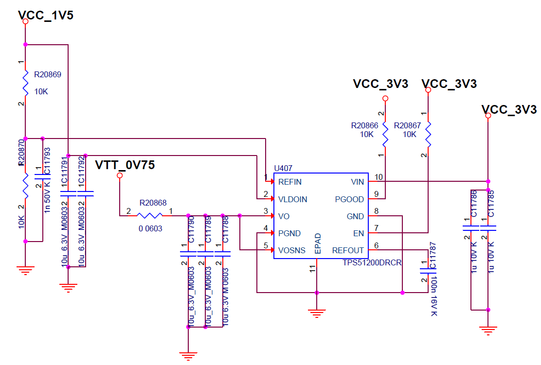

Dear Team,
Do you have further comments for this schematic?
BR
Kevin
