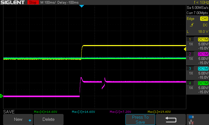

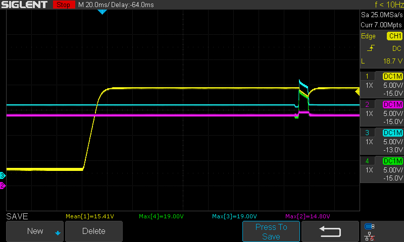

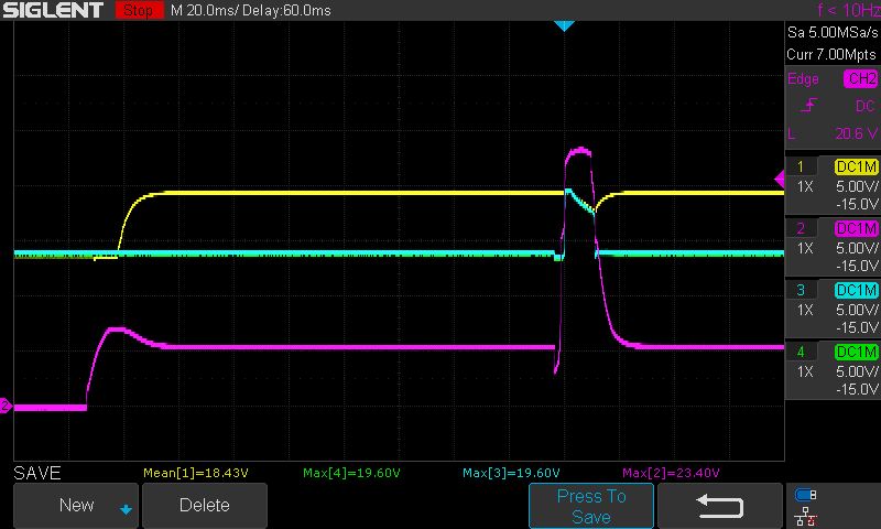

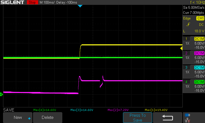

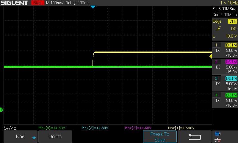

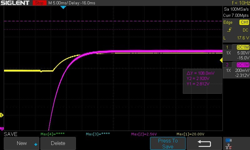

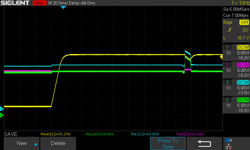

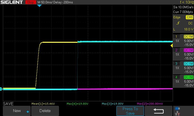

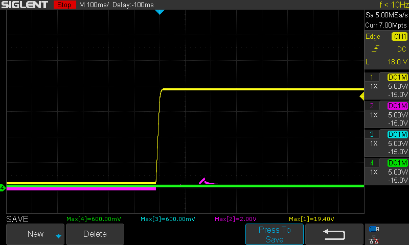

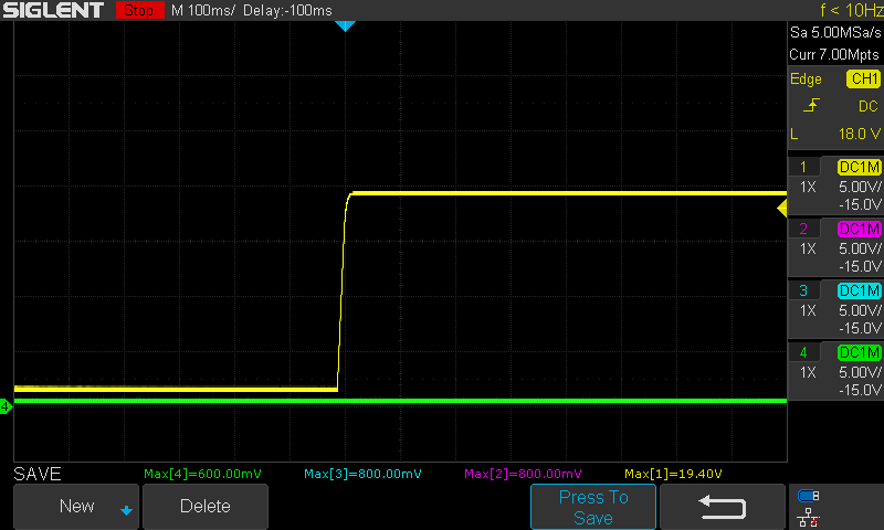

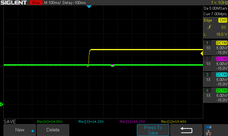

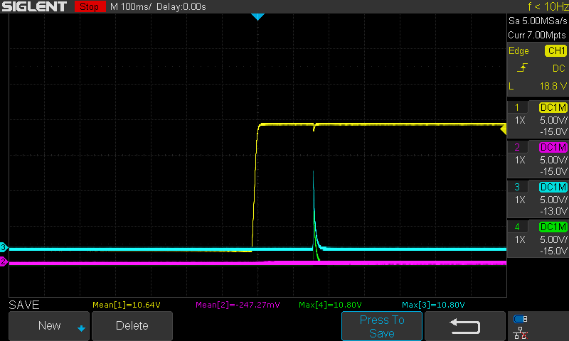

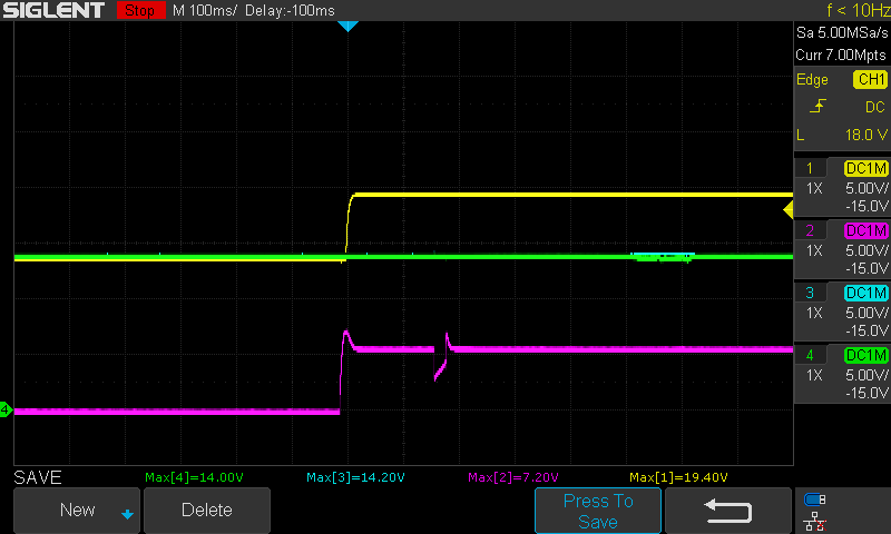

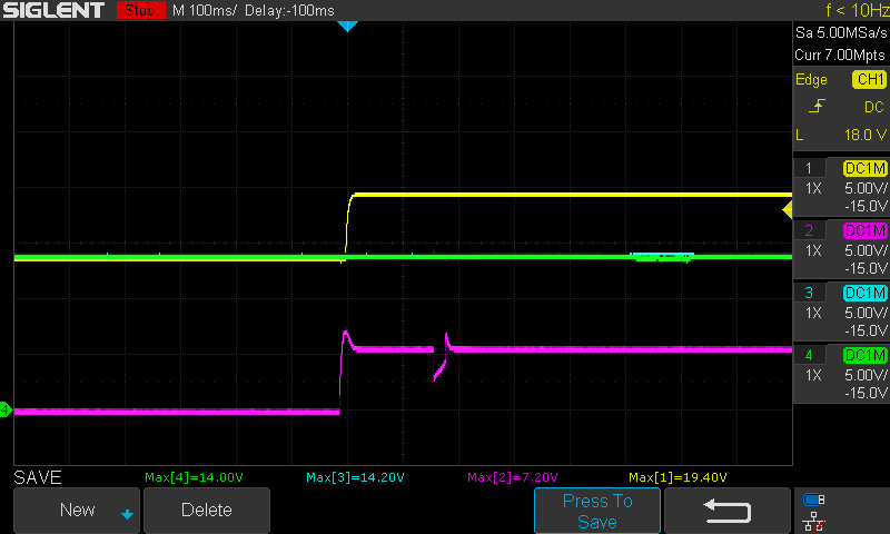

  • Hi, Joel

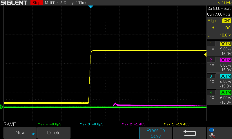

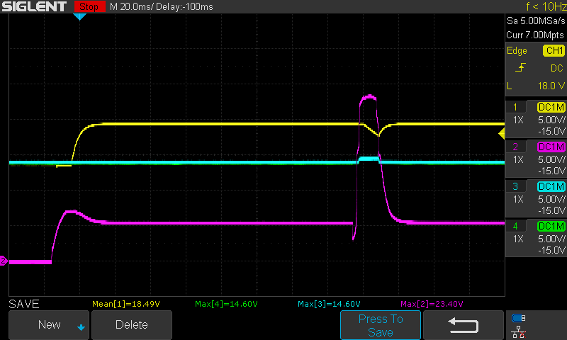

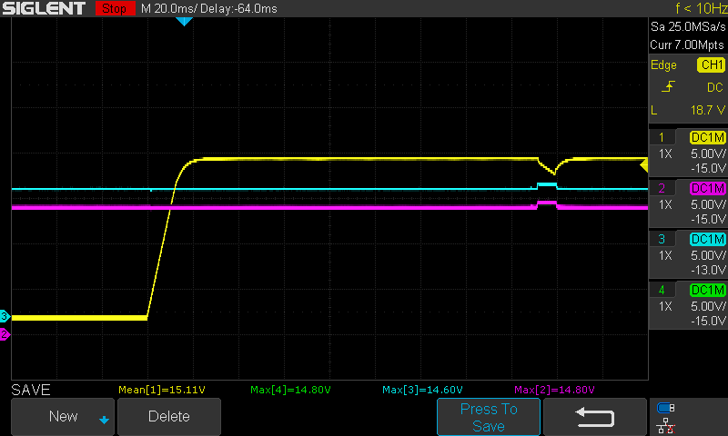

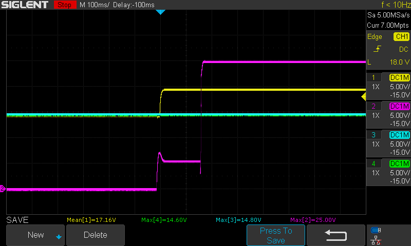

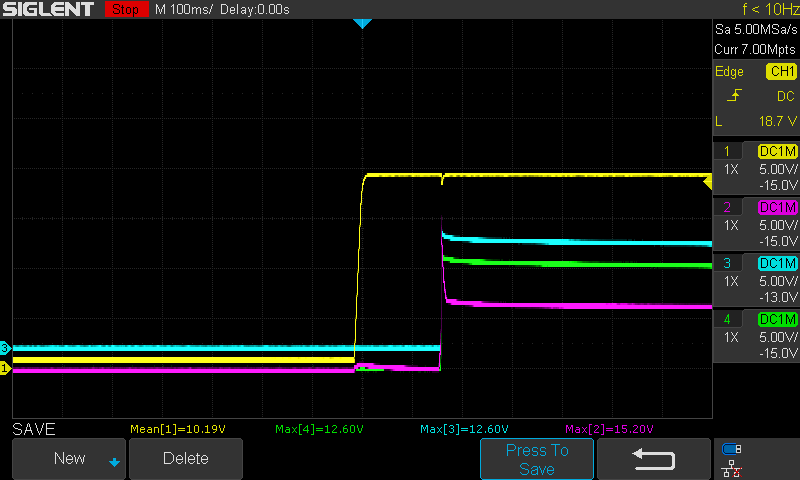

    Here are some scope captures for you to help identify the problem
    Pic1 loaded 15 ohm
    CH1 VCC
    CH2 SRN
    CH3 Current input R19
    CH4 Current input R19
    Pic2 Loaded 15 ohm
    CH1 VCC
    CH2 ACDRV
    Pic3 unloaded
    CH1 VCC
    CH2 SRN
    Pic4 unloaded
    CH1 VCC
    CH2 ACDRV
    Pic5 unloaded with Batteries
    CH1 VCC
    CH2 SRN
    Pic6 Loaded 15 ohm with Batteries
    CH1 VCC
    CH2 SRN
    Pic7 unloaded with Batteries
    CH1 VCC
    CH2 ACDRV
    Pic8 Loaded 15 ohm with Batteries
    CH1 VCC
    CH2 ACDRV
    Pic9 unloaded with Batteries
    CH1 VCC
    CH2 ACDRV
    CH3 Current Battery R27
    CH4 Current Battery R27
    Pic10 Loaded 15 ohm with Batteries
    CH1 VCC
    CH2 ACDRV
    Thank you for your help
    Olivier
  • I need to review these waveforms Olivier,
    But just to confirm, I see the input current channels are measured in Volts, instead of Amps. Can you verify the scale and unit of measure?
    Joel H
  • We don't have a current probe on our scope so we took the voltage on each sides of R19 for the input current and R27 for the charge/battery
    As for the actual 19V Source, the current was set to 1Amp but never produced more than 0.01Amp when it was connected
    Olivier
  • Hey Olivier,
    Let's try two tests:
    1) Remove C17 and C18 and retry this test.
    2) On aother board, increase the C16 capacitor to 0.47uF and retry the test.
    Joel H

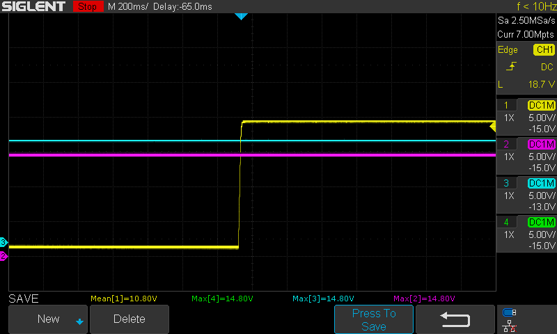

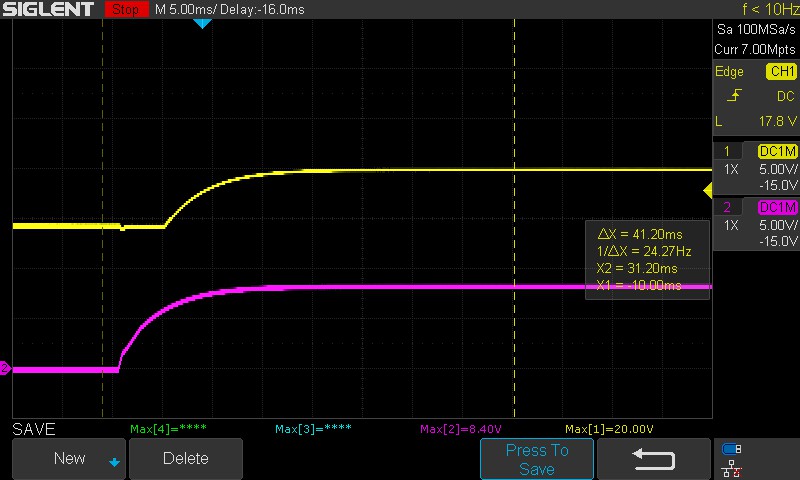

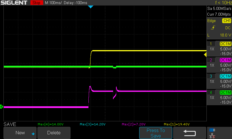

  • Hi Joel here the results we have
    Here are the same 10 graphs from the previous post without C17 and C18
    Pic1 loaded 15 ohm
    CH1 VCC
    CH2 SRN
    Pic2 Loaded 15 ohm
    CH1 VCC
    CH2 ACDRV
    Pic3 unloaded
    CH1 VCC
    CH2 SRN
    Pic4 unloaded
    CH1 VCC
    CH2 ACDRV
    CH1 VCC
    CH2 SRN
    CH1 VCC
    CH2 SRN
    CH1 VCC
    CH2 ACDRV
    CH1 VCC
    CH2 ACDRV
    CH1 VCC
    CH2 ACDRV
    CH1 VCC
    CH2 ACDRV
    We then did the test by changing C16 to 1uF because we didn't have a 0.47uF in hand
    Pic1 loaded 15 ohm
    CH1 VCC
    CH2 SRN
    Pic2 Loaded 15 ohm
    CH1 VCC
    CH2 ACDRV
    Pic3 unloaded
    CH1 VCC
    CH2 SRN
    Pic4 unloaded
    CH1 VCC
    CH2 ACDRV
    CH1 VCC
    CH2 SRN
    CH1 VCC
    CH2 SRN
    CH1 VCC
    CH2 ACDRV
    CH1 VCC
    CH2 ACDRV
    CH1 VCC
    CH2 ACDRV
    CH1 VCC
    CH2 ACDRV
    We concluded the higher value at C16 was not helping the circuit and ACDRV was not able to drive with the 1uF cap

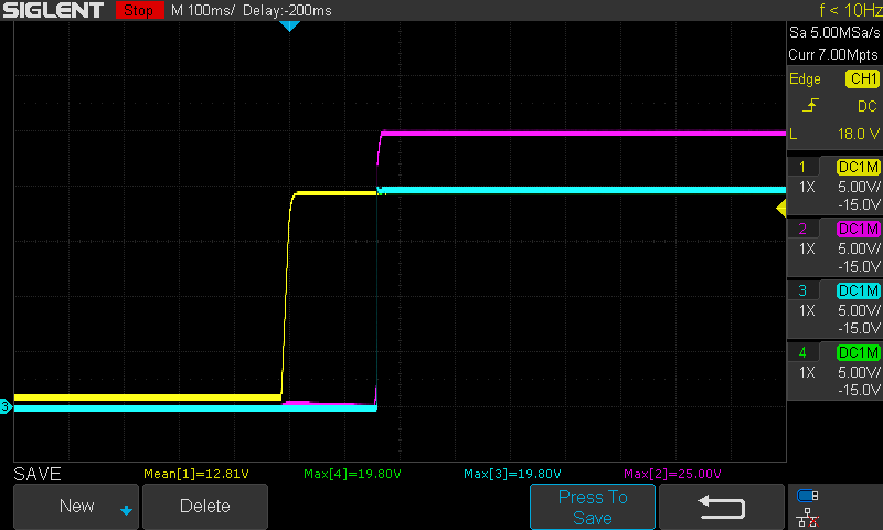

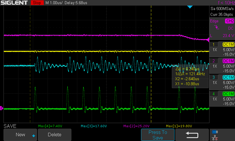

    We also did a bit more searching on our own and we noticed something strange behavior at HIDRIVE
    Once the input is turned on, the ACDRV works properly and the BATDRIVE goes down to let the Charger take control, but after 1-2 seconds the ACDRV goes back down
    We probed the HIGH and LOW drive to see and theses are the results
    CH1  VDD
    CH2 ACDRV
    CH3 HIDRV
    CH4 LODRV
    We are not sure if this is normal and we can see that ACDRV starts to drop. We can`t see it in the picture but it drops to zero right after.
    We think the behavior we are seeing throughout theses tests is the 8.4.18 Inductor Short, MOSFET Short Protection because it describes exactly the response from the IC
    Hope all this informations is helpful
    Olivier
  • Hey Olivier,
    I was looking at the first set of waveforms and I am noticing that the VCC voltage seems to droop about 1V or so (5V/div scale), which means that VIN is also drooping with the same magnitude.
    You also mentioned you are using 19V input with 1A current limit. However, your load on pictures 3/4 and 6/8 are with a 15-Ohm load, which means the input current would be roughly 1.3A of peak current. Even though the DC current you saw was only 0.01A, you like did not see the peak current. It is very difficult to measure using the R19 capture you have taken because the differential voltage we are looking for between CH.3 and CH.4 is on the order of 10mV, and we are seeing a 5V/div scale.
    We can try several things:
    1) Confirm that the unloaded cases starts up. From pictures 1/2 and 5/7 of the original set of waveforms, you mention the system is unloaded, yet I still see the same characteristic glitch on VCC, which would assume the voltage is still drooping, perhaps from inrush current.
    2) Increase the input power rating, both voltage and current. So use something like 20V w/3A current limit.
    3) Either depopulate R28 (66.5kOhm) or increase its value to the same as R24 (430kOhm).
    From the second set of waveforms, it seems that either removing the delay elements make the issue worse with an increased current spike, and increase the 0.1uF delay element by 10x slows the response too much which may trigger some other logic.
    I cannot explain the HIDRV waveform yet, but let's take a look at my actions for (1), (2), and (3) above. I would also suggest capturing the ACDET voltage (instead of the input or battery currents as they are not providing too much information right now). If you capture the ACDET voltage, please put a 2.4V offset, and set to 100-200mV/div vertical scale to capture any dip on ACDET.
    Joel H

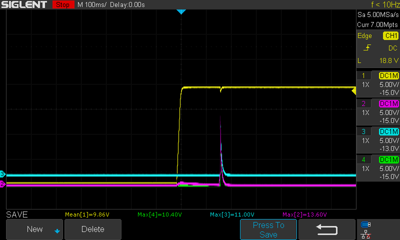

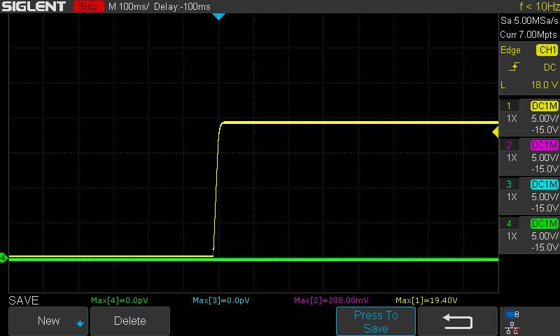

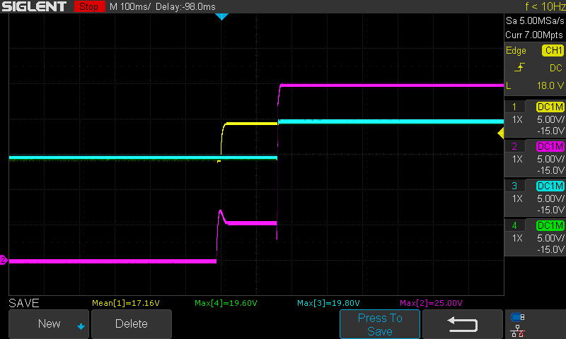

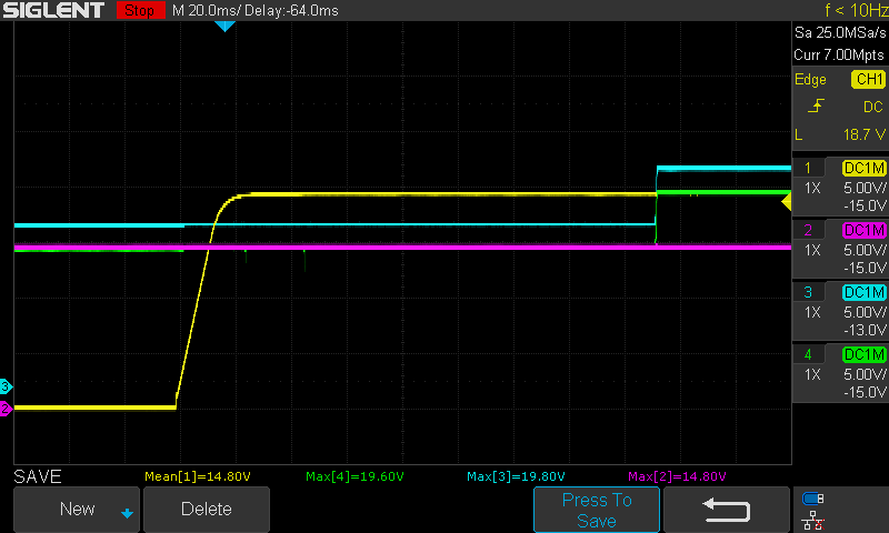

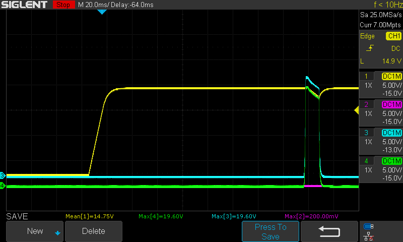

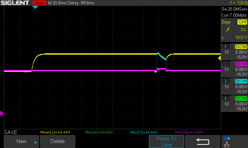

  • We tried to increased the current and voltage to 20V/3A and nothing seemed to change from the charging perspective.
    With our unloaded setup this is what we see,
    We also checked the ACDET and without the modification mentioned at step 3  here are the results
    After theses tests we don't think it is related to ACDET or the inrush current because the ACOK is acting correctly and no drop was seen on ACDET.
    We also tried to change the resistance at the ACDET to a 430kOhm, we don't understand why because the datasheet specifies that When the ACDET pin voltage is higher than 3.15V, it is considered as adapter over voltage. ACOK will be pulled low, and charge will be disabled. ACFET will be turned off to disconnect the high voltage adapter to system during ACOVP. BATFET will be turned on if turns on conditions are valid. See the System Power Selection section for details. We did try it and as expected the voltage at ACDET was around 9V and ACOK went down.
  • We finally found the problem with the board, the LowSide transistor's ground pas was not soldered properly, but when testing the continuity the pressure applied was enough to bring back the connection hence why it took so long to figure it out.
    Thank you for all the help
