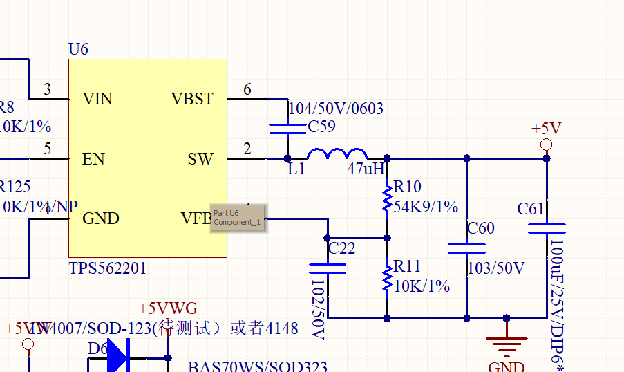

TPS562201: If the Output Capacitor affect the performance? if there any risk not use the recommended value? The C61 as below .
Part Number: TPS562201

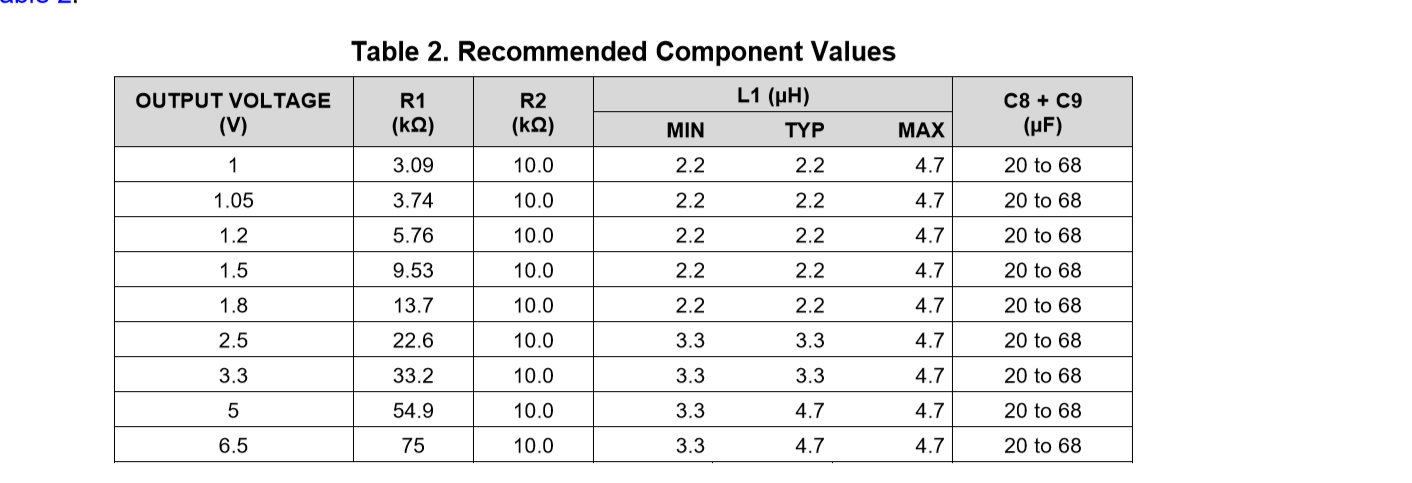

    The large output capacitor may lead to lower phase margin, the system may be unstable, but I think 100uF is fine.
    47uF inductor is too large, please use the recommended value, 3.3uH or 4.7uH.
    Why don't you use the recommended values?
