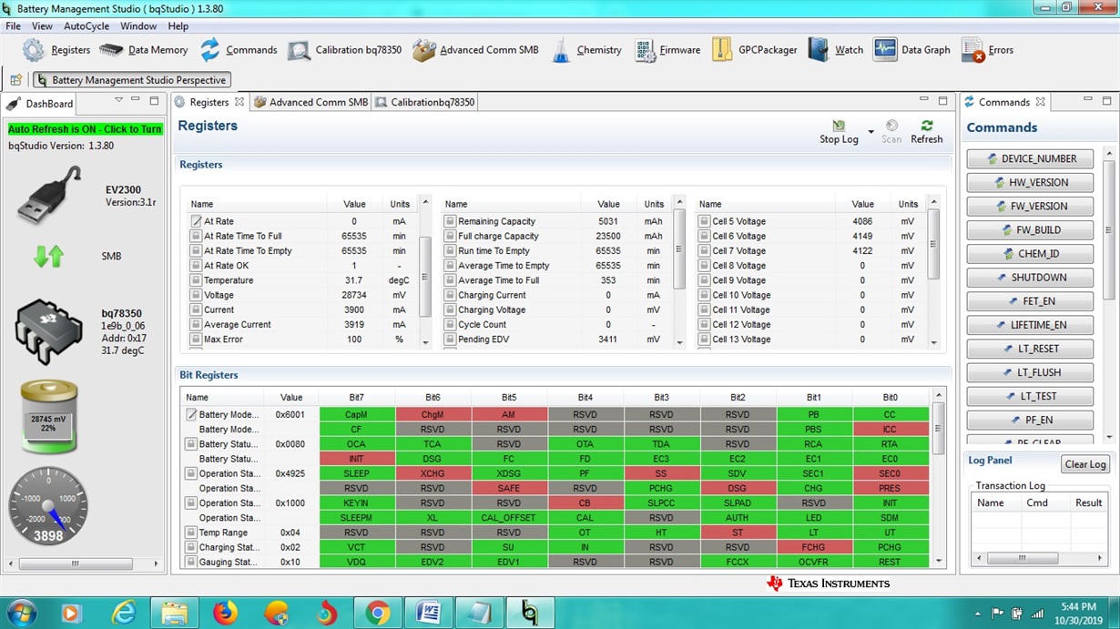

We have a 29.4V 23.5Ah Lithium polymer battery pack with bq78350 BMS.
The full charge capacity IS 29.4V which is 100% SOC but it is showing a improper percentage value for 28.74V it should be around 90% but its showing as 22% how to change SOC parameter.

  • Hi thanks for the help but how to change the Remaining capacity value in the register can you suggest me .The actual remaining capacity value is 21000mAh but it is reading as 5000mAh value
  • Harish,
    Did you initialize the Learned Full Charge Capacity parameter and the Design Capacity Parameter in on the Data Memory screen? Both of these should be initialized to the same value. After the battery completes a full qualified discharge, the Learned Full Charge Capacity will get updated.
    Matt
  • thanks Matt
    this resolved my issue its been great that you supported me for thhis threads.
