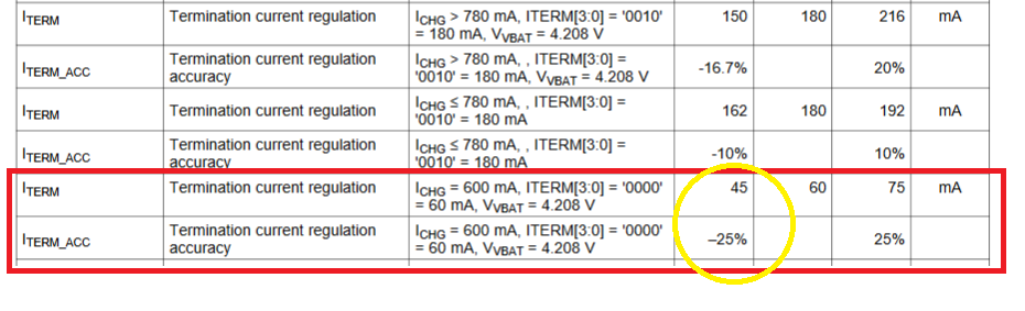

1.As described in the specification, his termination current when Ichg=600 TYP=60 MIN=45 MAX=75 with accuracy of -25%&25%.
Can it be understood that, in the minimum case, the termination current is equal to 45+45* (-25%)?The minimum termination current is 33.75mA.

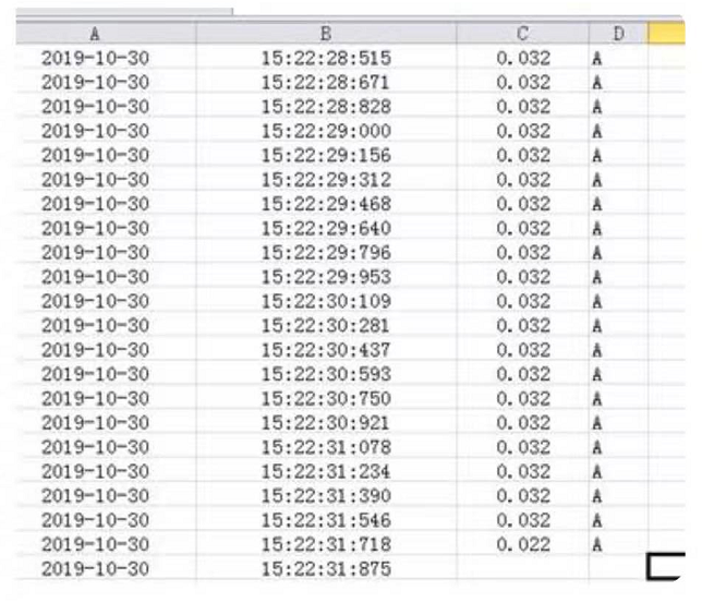

2.The actual termination current we tested was about 30mA, as shown below
