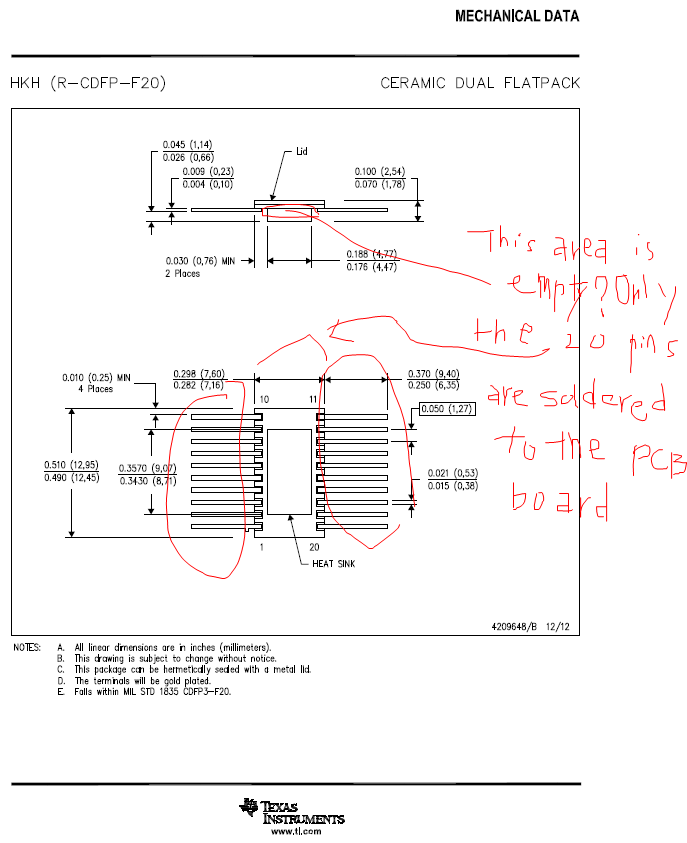

2) When the 20 pins of the TPS50601A-SP device is soldered to the PCB board, I believe the bottom case of the 50601A-SP device is floating in the air, and the area which I circled is empty , and when there is 1W loss in the TPS50601A-SP device itself, the worst case temperature rise of the internal junction of the TPS50601A-SP device will only have 0.514 deg. C temperature rise above the ambient temperature ? i.e. this is the absolute worst case temp rise per watt the device will encounter. and this can be used in the WCA effort to bound the temp rise.

    Q4: When the 20 pins of the TPS50601A-SP device is soldered to the PCB board, I believe the bottom case of the 50601A-SP device is floating in the air, and the area which I circled is empty , and when there is 1W loss in the TPS50601A-SP device itself, the worst case temperature rise of the internal junction of the TPS50601A-SP device will only have 0.514 deg. C temperature rise above the ambient temperature ? i.e. this is the absolute worst case temp rise per watt the device will encounter. and this can be used in the WCA effort to bound the temp rise.
    [CY] Firstly, the device should not be floating in air.  The circled part of the picture you provided is the heat slug of the package and should be mounted to a sufficient heat sinking mass on the PCB.  Page 4 of the SMD for this device defines such a heat sink in the test board conditions.
    Test board conditions:
    a. 2.5 inches x 2.5 inches, four layers, thickness: 0.062 inch.
    b. Two ounces copper traces located on the top of the PCB.
    c. Two ounces copper ground planes on the two internal layers and bottom layer.
    d. Four 0.010 inch thermal vias located under the device package.
