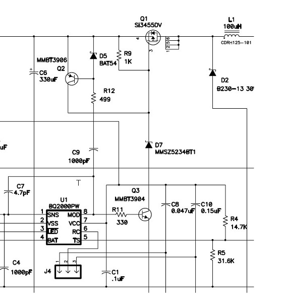

We have very simple question for  EVM circuit .
1)   About EVM  FET Gate Pin control circuit.
     We use FET as Charge current control with BQ2000 and almost same schematic  BQ2000 EVM
     But this FET control by Q2 and Q3  Transistor  and MOD Pin .
    My question for  Could you tell us about these Q2 and Q3 Transistor  Purpose and  Operating principle.
    Yes we know these Transistor and MOD output control  FET gate Pin.
    But Sorry..  I don't understand this behavior well.
 2) About  D7   MMSZ5234 BT7
       This Q2 and Q3 control   Q1 FEt gate and connected  D7  ZD Diode  MMS5234BT1.
      Our customer this D7 ZD diode change to   normal   Resister  100 ohm.
      Is this Ok  ??     Because of   we checked Current waveform and we found   Charge current DC offset change to  upper side. (DC Level changed to Big ).
      If  DC Level will shift  , this mean  Average Current  Waveform  change to  small or big .
      My guess  this  Q3 Transistor  and D7 ZD Diode make Voltage Regulator and connect to FET gate , Yes DC Bias Level fix by this Q3 and D7.
      If  Customer  this Diode changed to Resister 100 Ohm, I think no good for FET Control.
     Could you tell us  side effect  when  D7 diode change to  Resister ??

    Q3 inverts the MOD output so it can drive a PFET.  Q2 is part of Q1 fast turn off circuit.  D7 is Zener clamp to protect gate of Q1 (EVM rated for up to 25V input) but will also help with Q1 fast turn off since the gate is not pulled all the way to ground at turn on.  If you input voltage is low enough not to exceed PFET max gate voltage, then D7 is not required but, again, will help with Q1 turn off time.
    Regarding charge accuracy, this charger's SNS pin is very sensitive to switching noise.  EVM resistor R13 and C4 form an RC filter with C7 adding some hysteresis to help minimize this noise.  Board layout is also a factor.  Adding a 0.1uF capacitor in parallel with EVM C6 and C3 may also help.
