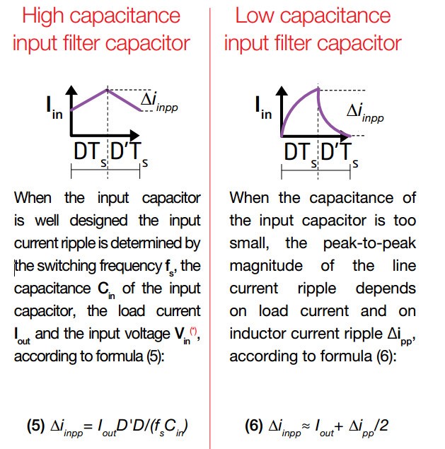

I want to calculate buck input current ripple. How can choose from formula(5) and formula(6)? I don't know how to judge high and low capacitance,can you kindly teach me please?

Appropriate input capacitor can usually sustain the voltage in case of any line transients. Increasing the input capacitance helps reduce input voltage ripple as well. There is usually a minimum requirement of input capacitors stated in the datasheet for stability. This will usually follow equation 5. In Equation 6 you can see poor input capacitance can lead to the input current not sustaining and hitting the floor every switching cycle.
