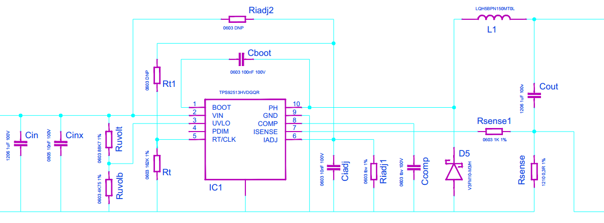

  • Dear Irwin,
    Thanks for your support.
    We want to test this option: 'You can try PWM to and RC filter sent to iadj to see how it behaves.'
    See attached schematic as it is now. Do you mean to make an RC filter with Ciadj and Riadj1?In this case we will not place Riadj2 and Rt1. So without using the PWM input.
    Can you advise if  this is correct and which values we can start with for Ciadj and Riadj1?
    Thanks in advance,
  • Hello Cees,
    I cannot calculate your values without know more information such as Vin, Vin range.  You can calculate your RC values fairly easily.
    The iadj pin when pulled high to 2.77V can sink 100 uA (this will set the minimum upper resistor value if you choose to use it this way).  If you use both Riadj1 and Riadj2 you can set the divider to charge to a known value below 2.77V (3V is the absolute maximum of the iadj pin)  The voltage from low to high current will be 0-1.8V.  This is an RC calculation, you can calculate this or simulate it because it will behave different depending on the values chosen.  The power down reset time will depend on how you implement this.  A single resistor, Riadj2, and using the 100 uA maximum sink current will make the ramp more linear but it will also cause the reset time to be longer since it has to discharge through Riadj2 when it is off.  If your resistor values are high there is a current sink (iadj clamp) you have to take into account, 1 uA at 1.8V on iadj.  The Ciadj capacitor will need to be much larger for your time constant.  For example using 10 uA charging current and 500 mS the capacitor value would need to be 2.8 uF.  Using PWM to an RC to the iadj pin will reduce this capacitor value down dependent on PWM frequency.
    The power up may not behave the way you expect, this part was not meant to start this way.  A hysteretic part such as the TPS92515 would be better suited to do this.  Rt1 shouldn't be used this way, the RT pin is for setting switching frequency and cannot pull up on Iadj.

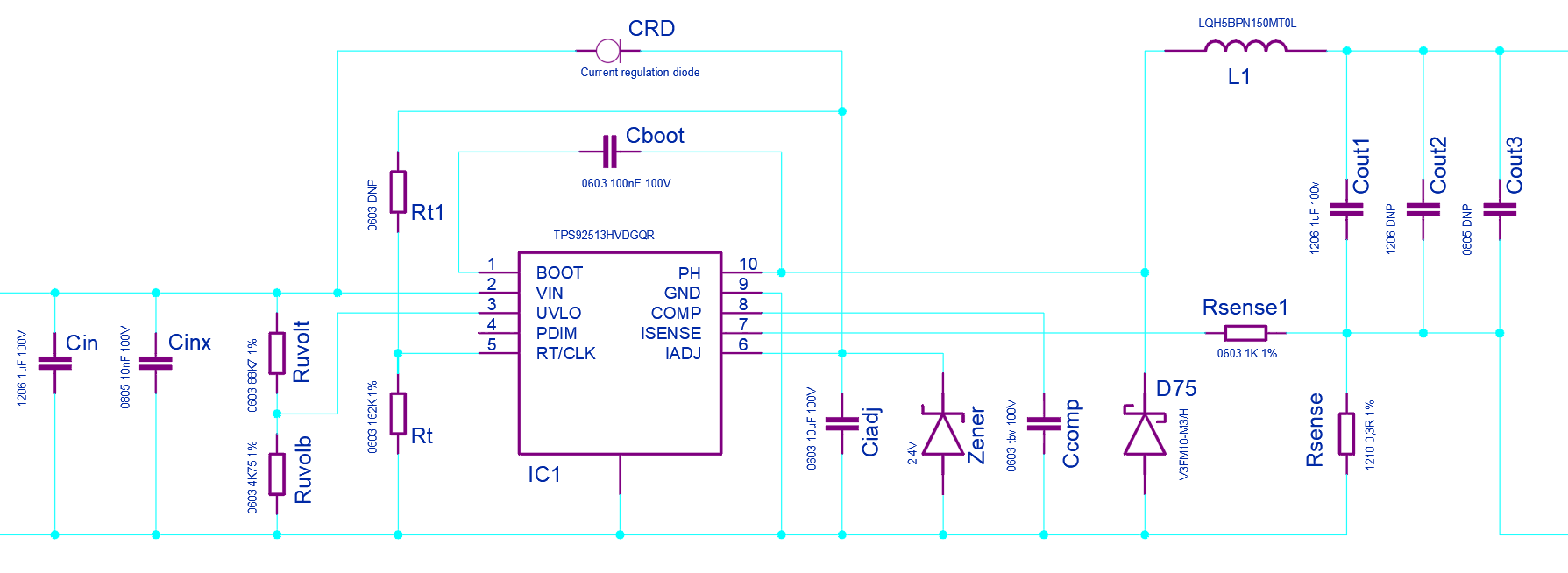

  • Hello Irwin,
    The Vin working range will be 24-48Vdc. But there might be accidental fluctuations to 55Vdc. Due to this wide input range and the 3V absolute maximum for IADJ it's not possible to use a fixed voltage divider.
    We think about using a 2,4V Zener diode instead of Riadj1 and a current regulation diode (CRD) instead of Riadj2.Then it would be possible to charge Ciadj with any supply voltage and clamp IADJ at a maximum of 2,4V regardless high fluctuations on the supply.
    See schematic below.
    Please let me know your thoughts on this idea? Do you see any problems with such solution?
    Thanks in advance, Cees
  • Hello Cees,
    The Iadj pin can be pulled above that voltage if the current is below 100 uA.  This means at 55V you can use 520 Kohm as the pull up on the RC or higher.  The value can be even when calculating with the bottom resistor of the divider.
    Try 499 Kohm for the top resistor and 56.2 Kohm for the bottom, or something like that with a 4.7 uF capacitor or the10 uF you already have on the board to Iadj to see how it works.
    Worst case current to Iadj in this case would be (55V - 3V)/499 Kohm - 3V/56.2 Kohm = 51 uA, well under 100 uA.
    A current regulator diode is not common or inexpensive.  It can also be created with discrete parts.  If the variance in turn on time with respect to input voltage is not desirable a separate resistor/zener can provide a fixed voltage to base the RC on.
