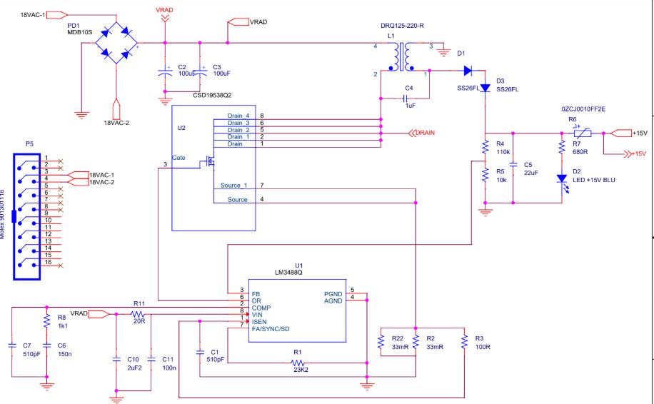

Good morning,
I designed a SEPIC using LM3488Q,
the problem is that when i turn on my power supply the output voltage stays at 3V (instead of 10V),
the Power mosfet does not have enough Vgs and the amount of current in the inductor keeps growing.
The scheme is the following:
the only difference is the power mosfet that I am using: FDD120AN15A
  • Hi Raul,
    Thank you for designing with the LM3488.  Please first check if your transformer polarity is used correctly.  If no problem with the transformer polarity, could you monitor the following signals:
    (1) VIN Pin
    (2) DR pin
    (3) U2 Drain
    (4) COMP pin
    Capture all these four signals on the same scope picture, and show zoomed out (at least 10 cycles) and zoomed in (two cycles)?
    In another scope picture, can you monitor
    (1) DR pin
    (2) ISEN
    Youhao XI, Applications Engineering
  • Thanks a lot,
    I found the issue, the sense resistor sets the current limit higher than the power supply limit,
    in this way the peak current never reach the threshold to start the transfer of power and begin the normal operation.
    The solution was increeasing the value of Rsense to 100mOhm, then to avoid ripple current limitation I also increased the value of the inductor to 68uH.
