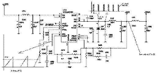

How can TPS54350PWP oscilate at about 150Hz?
Other Parts Discussed in Thread: TPS54350
Dear Sir/Madam
I am troubleshooting a WiMAX product in a factory, and I meet a lot of units which output voltage only 1.1V(shall be 6V). I did some test for these units, and I draw the waveform in the schematic diagram. I think TPS54350PWP was forced into oscilating by some feedback loop, but I don't know which path will cause this kind result. Would you help me to analysis this circuit and give me some suggestion?Thank you very much!
Jim
