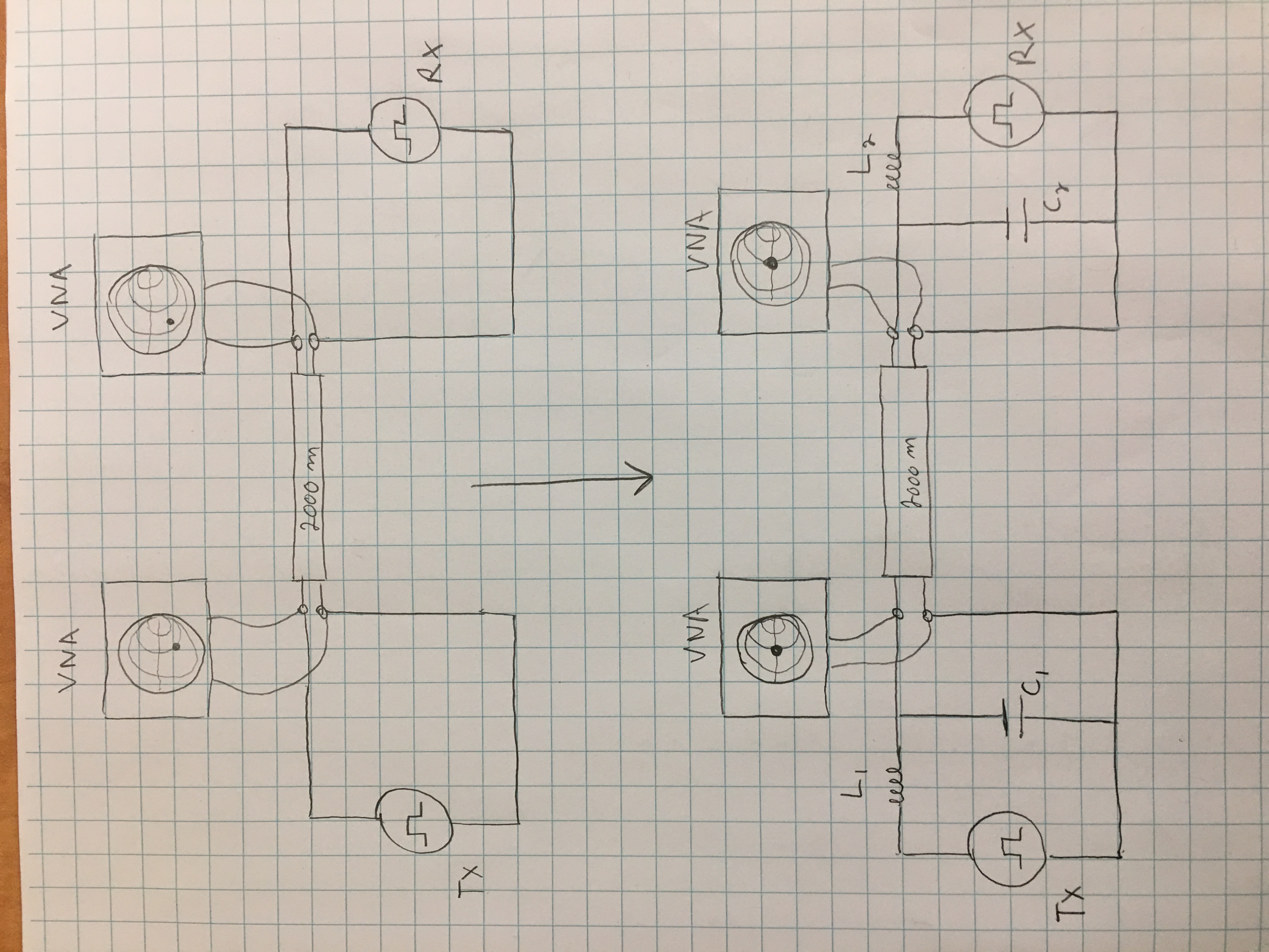

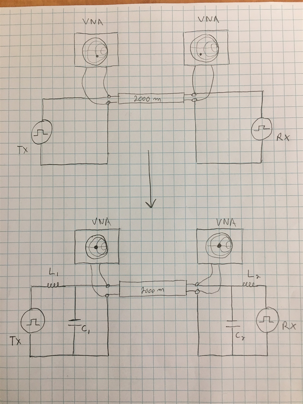

I am new to impedance balancing so bear with me. I have a transmitter and receiver with 2000 meters of electrical cable connecting the two. The signal I am transmitting is a 3.3 volt digital signal. I am trying to impedance balance this network and a bit confused where to hook up my VNA.  I drew a diagram below, is this correct?  If I understand it, my VNA connects to the transmitter circuit while it is connected to the 2000 m transmission cable, which is then connected to the receiving circuit. Using my VNA and a Smith Chart, I will impedance balance the TX circuit with some "L" network including a certain value inductor and capacitor.  After that is balanced on the VNA, I connect my VNA at the receiving end and do the same type of impedance balance.
Does this make sense or am I going about this wrong?  Thanks for any input anyone has.

    The high level approach you suggested is pretty much correct but I will comment on a few things.

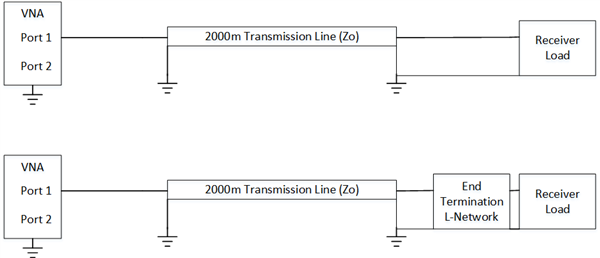

    In your diagram you show a VNA and a TX Data transmitter source. During this process, the VNA becomes the transmitter source and simultaneously transmits a sine wave of a particular frequency and monitors the line for both the transmitted signal, and any reflected signals which it uses in its calculations. You can typically set the VNA to use a particular frequency, or to sweep a frequency range. When you are trying to match impedance, you will need to use a single frequency.

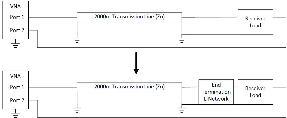

    Also, of importance is that you will need to place the VNA on the other side of any of your L-Networks and not as shown in your figure. The ports of the VNA need to see the signal “through” the components and not at the end of the transmission line before the signal as passed through the matching network components. These components are added to the Load and therefore the VNA must be connected at the far end of the network.
    Also, I’ll discuss more later in the post, but typically you will only place a matching network on the Load side of the transmission line near the receiver and you do not need to match the source impedance to the characteristic impedance of the transmission line if the load impedance is properly match to prevent reflections traveling back down the transmission line to the source.
    The following two diagrams would be where I would make the connections. First, connect one port of the VNA to the transmission line and the other to the far end of the “load” which will include the receiver. Then, use the Smith chart to calculate the proper L-Network component values and add them into the system and tune the system until the Load impedance seen by the transmitter equal the characteristic impedance of the transmission line.

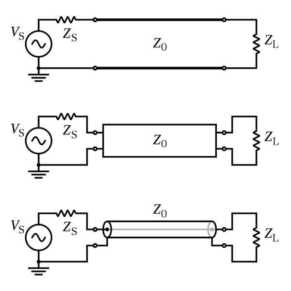

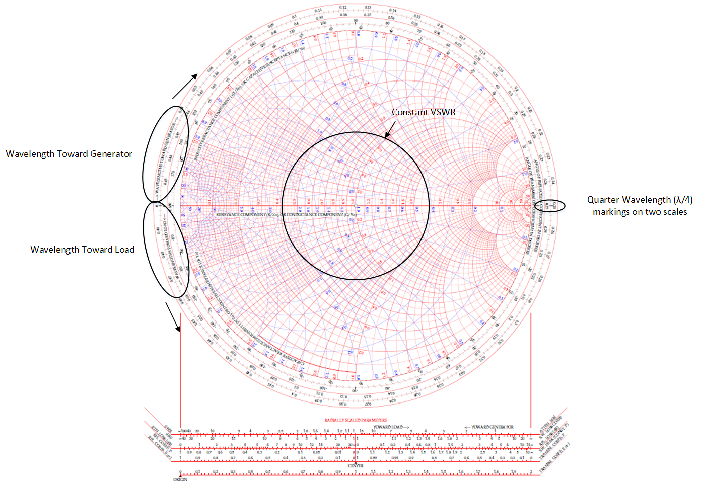

    There are three different impedance values that need to be considered in a system like this. There is the Source Impedance ZS, the load impedance ZL, and the transmission line’s characteristic impedance ZO.

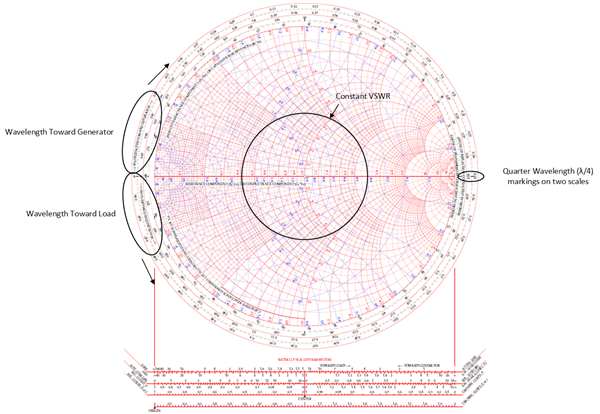

    If you were to connect the Load directly to the source without going through the transmission line, the impedance of the Load that the Source sees will be different than the impedance of the Load seen by the source looking “through the transmission line.” The VSWR seen by the source is Constant, but the actual Impedance changes. This means that different impedance values will result in the same VSWR, or amount of reflected energy.
    This is because adding or subtracting length to the transmission line will rotate you around the Smith Chart and change the complex impedance. Each rotation around the chart will represent ½ of the frequency wavelength (λ/2) and each half rotation will result in a ¼ wavelength (λ/4). The ZINPUT will equal ZLOAD when the length is a multiple of λ/2, regardless of the ZO or ZLOAD. The transmission line that is exactly a multiple of λ/4 length also has interesting properties in that it will appear to the source as an Open if it is shorted, and it will appear as a Short if it is Open due to the way the waveform reflections will interact with the source waveform. Therefore the exact length of the transmission line will determine where the complex impedance will be on the Smith Chart and what series and shunt L/C components will be required to match the impedance. If the complex impedance was plotted in the following Smith Chart such that is was on the Constant VSWR line, changing the transmission line length would cause that impedance to rotate around that circle through the Smith Chart.  If you have already created a matching L-Network, this would cause your "matched" network to no longer be matched and it must be re-calculated.
    There are three standard methods for ensuring a flat frequency response:
    1. End Termination: Adding series and parallel (shunt) inductor and capacitor elements to the load to match the impedance seen by the source equal to the characteristic impedance of the transmission line.
    2. Series (source) termination: Adding series and parallel (shunt) inductor and capacitor elements to the source to make the source impedance equal to the characteristic impedance of the transmission line. Note, this will allow for all reflected energy from the load to travel back towards the source before it is terminated.
    3. Shorten the line to make it “electrically short” and not behave as a transmission line. This is not an option for you with a 2000m cable unless your frequency content was extremely low.
    In your diagram, you show a TX side and a RX side and if data will flow in a single direction, you typically only need to implement one type of termination method (end or series termination) but not both types. End termination is the most common allowing the source to transmit the full spectral content of the signal into the transmission line and adjust the load impedance to match the characteristic impedance and eliminate any reflections that could be destructive to the signal.
    However, if the data is bi-directional, both sides of the transmission line may need to be addressed and both the source and load impedance’s will need to be matched to the characteristic impedance. One thing you will need to remember is that the series and parallel (shunt) inductor and capacitor elements that are added to the network will act as some form of filter and could cause other problems in successfully transmitting the data across the network. Reducing the number of filters and also carefully selecting the right component values will be critical to the overall success.

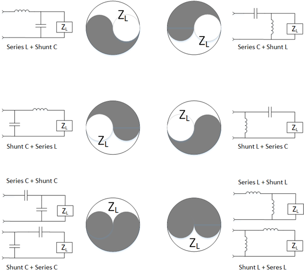

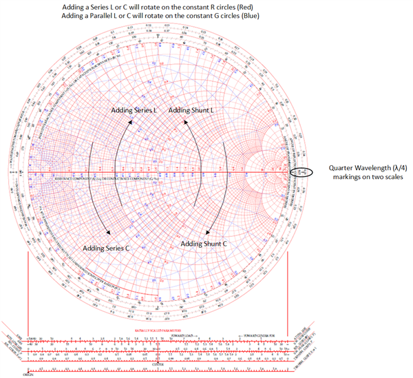

    After you have Normalized and plotted your complex load impedance as seen by the source through the transmission line on a Smith Chart, or viewed it on the VNA, your load will fall into one of several areas that may change the type of L-Network you choose to use. If your load falls into one of the un-shaded regions of the following figures, the corresponding two component network can be used to match the impedance to the normalized system impedance which is at the center of the Smith Chart.
    Adding Inductance causes you to “rise” upwards on the chart, while adding capacitance will cause you to “fall” downwards on the chart. Once again, the type of elements and network you chose may also need to be a consideration of other system goals and requirements such as Low/High Pass filtering, realistic values of components, etc. More complex networks can be created by adding more than 2 elements .
    You will typically add a series or parallel (shunt) element to move you to one of the Resistance or Admittance circles and then add the other component to move you to the center of the chart and the normalized system impedance which is typically 50Ω, 75Ω, or 100Ω, etc. depending on your transmission line cable.
    Here is an example of how a Series C + Shunt L network would move the impedance on the Smith Chart.

  • Hi Dustin,
    I have one additional point I would like to clarify.  I don't know what all measurements you care about when using your VNA, but if you only cared about the Reflection Coefficient S[1,1] as seen by the transmitter then you don't need to connect the second port of the VNA to the system and you can simply connect the VNA to the transmission line at the point of your transceiver.  You would then only need to tune the L-Network such that you see the system impedance of Zo.
    Jonathan
  • Hello Jonathan, thank you for the very detailed description on this. I will attempt to impedance balance this circuit as you have described.  Thanks!
  • You are right that the communication will only be one way (transmitter to the receiver) so thanks for clearing up that I will only need to impedance balance at the receiving end. I am not familiar with using VNA's yet but I'm sure with some reading I will figure it out.  Appreciate your response.
