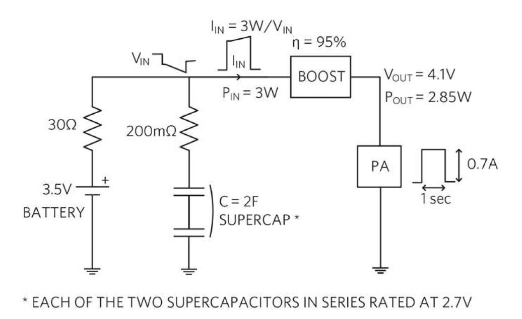

    Here is also a reference design similar to your requirements:
    I think the mastering the super-capacitor charging is the most challenge.  The following buck-boost design should be straightforward,  Let me know if you eed further assistance,
  • Hi John,
    Does it need to be that complex?  My initial goal - and sorry if this original question didn't address that - was to use a single cell 3.6V battery. Then, I decided had to use 2x in series to achieve the performance. However, I keep going back to this little app note I found on the web, it uses a "competitors" boost device. BTW - if I need to use 2 batteries in parallel due to poor temperature performance - I will do it. My preference was, and will be to use 1 though.
    It's near identical to what I need. Using a low quiescent current buck-boost converter, such as the TPS63805, would this not work? Once the battery charges the cap, it should have very low leakage current and will supply the necessary current when it's needed. Both voltage and current shown in this diagram are right where I need them. The difference - the "boost" device would now be a "buck-boost". Where are the problems or pitfalls with this?

  • I cannot think of any downside to using a buck boost.  My only concern was regarding the super-capacitor charging.  I am certainly not an expert with regard to battery and super capacitor charging, but the literature I have read deals with constant current/constant voltage charging, ESR monitoring, over current protection, etc.  That circuit is just RC charging with current limited to less than 116 mA by the 30 ohm resistor.
  • John,
    BTW - the diagram shows 700mA for 1 sec, my app is actually 500 to 600mA for not more than 500ms.
    Regarding your comments - understood. Is this simply too good to be true, maybe. After the initial charging of the cap, limited by Mr.30ohm, and while the load is very light (1mA in sleep mode for the device) , the input to the regulator would be appreciably small.So the losses would be quiescent current plus input current plus any leakage of the capacitor. Yes? Seems right...
    Then - when the load/device is awake, and requires a higher peak demand on transmit, the super cap would supply that as it has the lowest source resistance that's in parallel, with the battery that's in series with the 30 ohm. After the push from the super-capacitor, and the device again in sleep, the battery would then charge the cap to equilibrium again.
