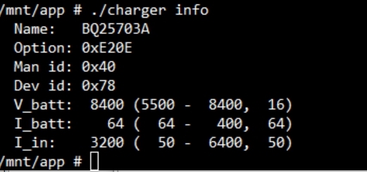

I am using BQ25703A for charging the backup battery of my device.
The main power source will charge the battery to full and stop charging.
When the main power is lost, it switches to this backup battery.
Is there any "default settings" for BQ25703A to use ?
By "default", I mean it definitely works. Current I could read and write 25703A's registers via I2C
(using Linux), and got the response from 25703A, shown as follows.
However, when I checked out ADC registers, all values are 0. It supposes that if my
settings are correct, ADC registers will have values (and changing over time).
I don't know I missed something. Can you please give me some heads-up ?
Thank you.
Alan
  • Hi Alan,
         From the setting, looks like your target VBAT=8.4V, Icharge=64mA, IINDPM=3.2A. I think your charge current is too small, this charge current should be your battery fast charge period constant charging current value.
         I suspect you don't enable ADC yet. You should enable 1 time ADC through setting REG3B[6]=1 or you can enable continuous ADC through REG3B[7]=1 shown below.

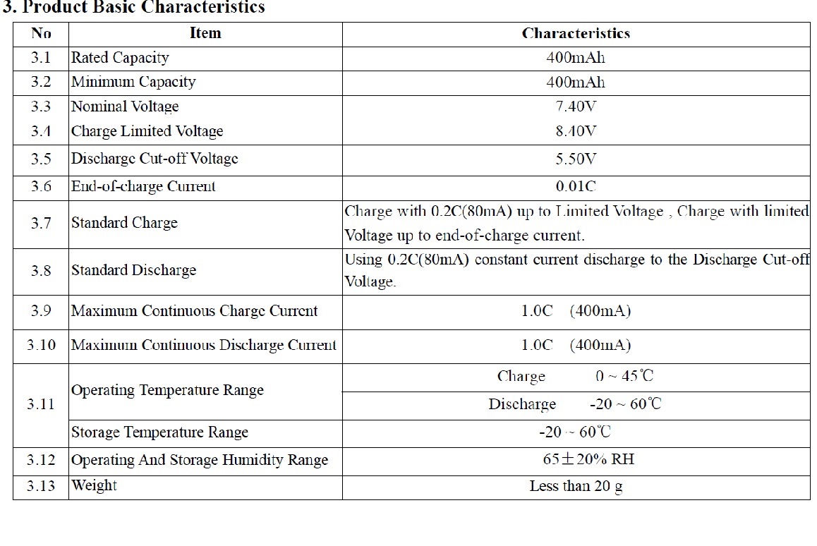

  • Hi, Shishuo,
    Enclosed please find the battery specs of this battery. We're actually confused about this.
    Although we did set it to 8.4V, which is max charge voltage, the battery-side gauge (protection
    IC model: HY-2120CB) might stops by itself for some reasons that we don't know ?
    Alan
  • Hi Alan,
        Thanks for providing the battery information, it looks fine. Could you monitor the charger status register REG21/20H to see if there is any abnormal status reported? It is also helpful if you can provide a charge cycle Current and Voltage waveform for further analysis.Thanks.
