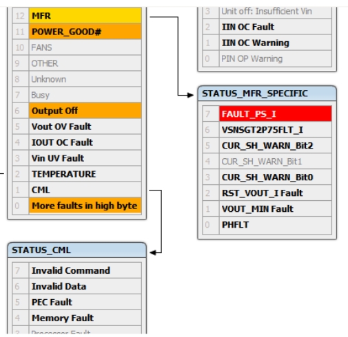

I found tps53667 reported FAULT_PS. I confirmed the power stages are fine. How to clear the fault bit to make TPS53667 recover to operate?

Hi Jerry,
Please check if TAO is keeping high, if not, use CLEAR FAULT command to clear this bit.
Chasel
