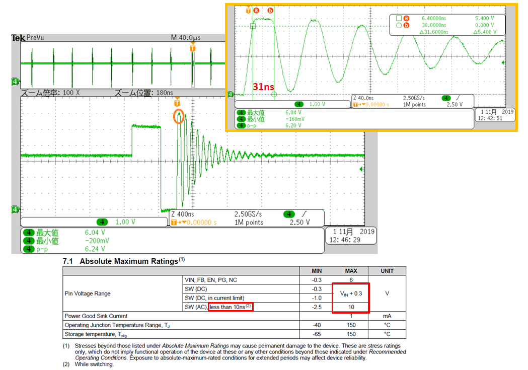

Hi Expert,
My customer have a question about SW node absolute max.
They found the following waveform that is over voltage Vin+0.3V(ABS MAX) on SW node and over 10ns.
Also, It seems, Body diode of High side FET turned on, because SW voltage is clumped by around 5.7V.
Conditions, Vin=5.1(max), Vout=3.3V
 I think, it is oscillation by inductance and LSFET capacitance at inductor current = 0A.
Does customer need to improve this waveform? (Regarding ABX max. this oscillation is normal behavior.)
Customer tried to change inductor from 1.0uH to 0.47uH. Oscillation frequency became higher. however maximum voltage was not improved.
Customer tried to reduce SW node parasitic capacitance by PCB layout cut. However, it is not solved.
Does this waveform any problem for system reliability?
Probe for this waveform.
