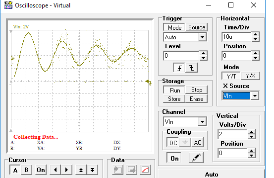

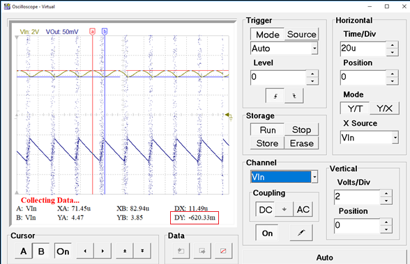

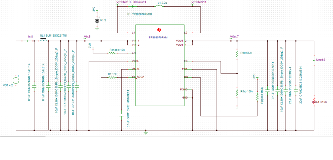

I have simulated buck/boost converter circuit with TPS63070RNMR in TINA TI. When I used ferrite bead in the input, I observe ripples in the input waveform (In schematic, VIn:5 node) after ferrite bead for both transient and steady state analysis.
My questions are:
1. Is it suggested to use ferrite bead in input. Because I don’t see any ripples at input supply without ferrite bead.
2. If yes, please suggest me a best way to reduce the ripples after ferrite bead in input to IC.
3. If no, please let me know the disadvantages of not using.
I have attached the simulation results and my schematic for reference.

  • Hi Ram,
    I am sorry for the delay.
    It is not necessary to use a ferrite bead at input, unless you have certain EMI requirements for your design. But even then, to suppress the noise you should first:
    • Follow the PCB layout guidelines from the TPS63070 datasheet, in order to minimize PCB parasitics.
    • Place a small high-frequency ceramic capacitor (0402, 100 nF) as close as possible to VIN pins, in order to filter high frequency noise.
    We did not test the device with input filters, as this depend on the specific requirements, and the filter can also interfere with the converter operation. I suggest you to first stick to the above recommendations in order to minimize the noise emission, and if after tests that is not enough, proceed to add input filtering or EMI shielding.
    Milos
