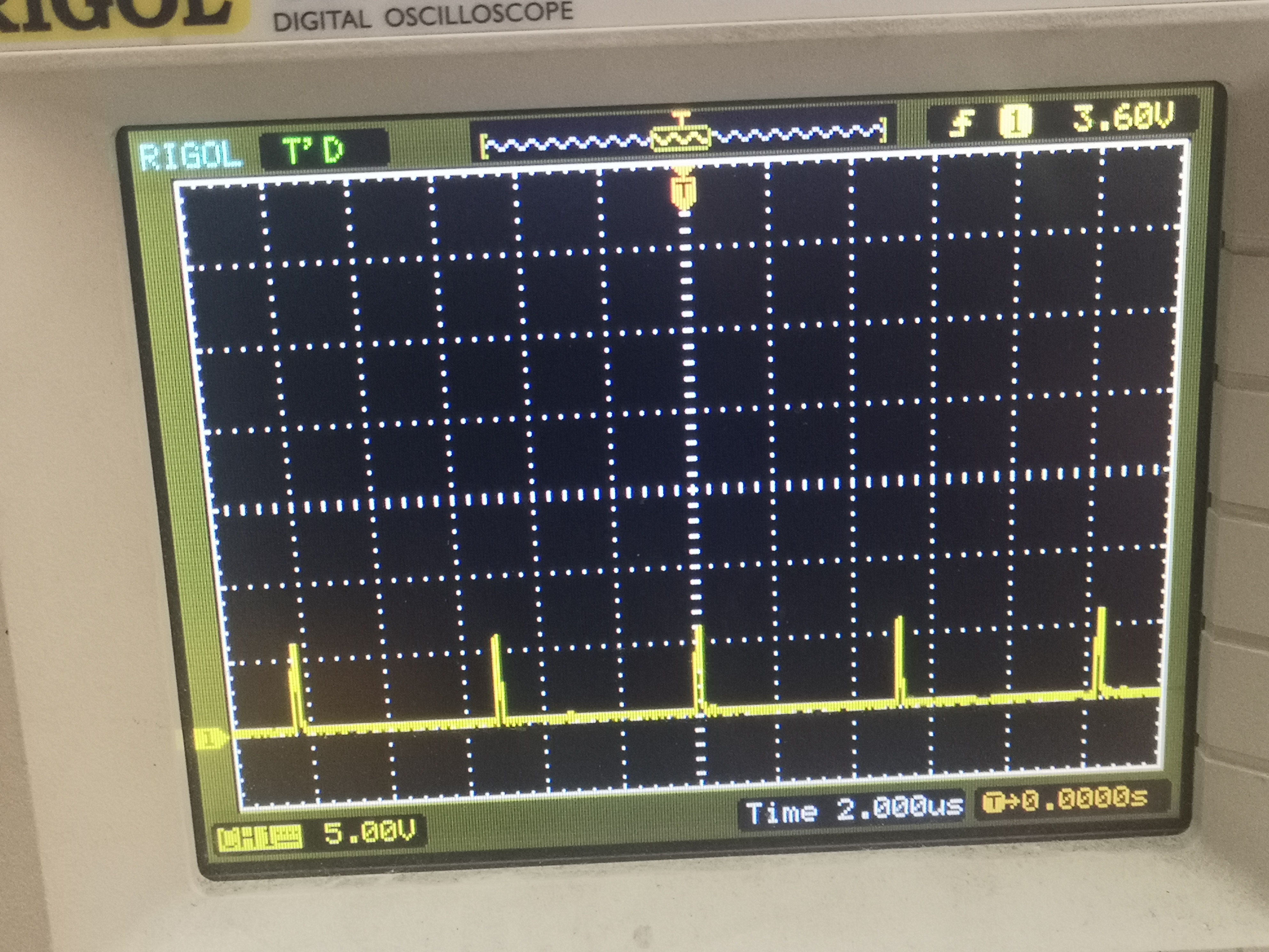

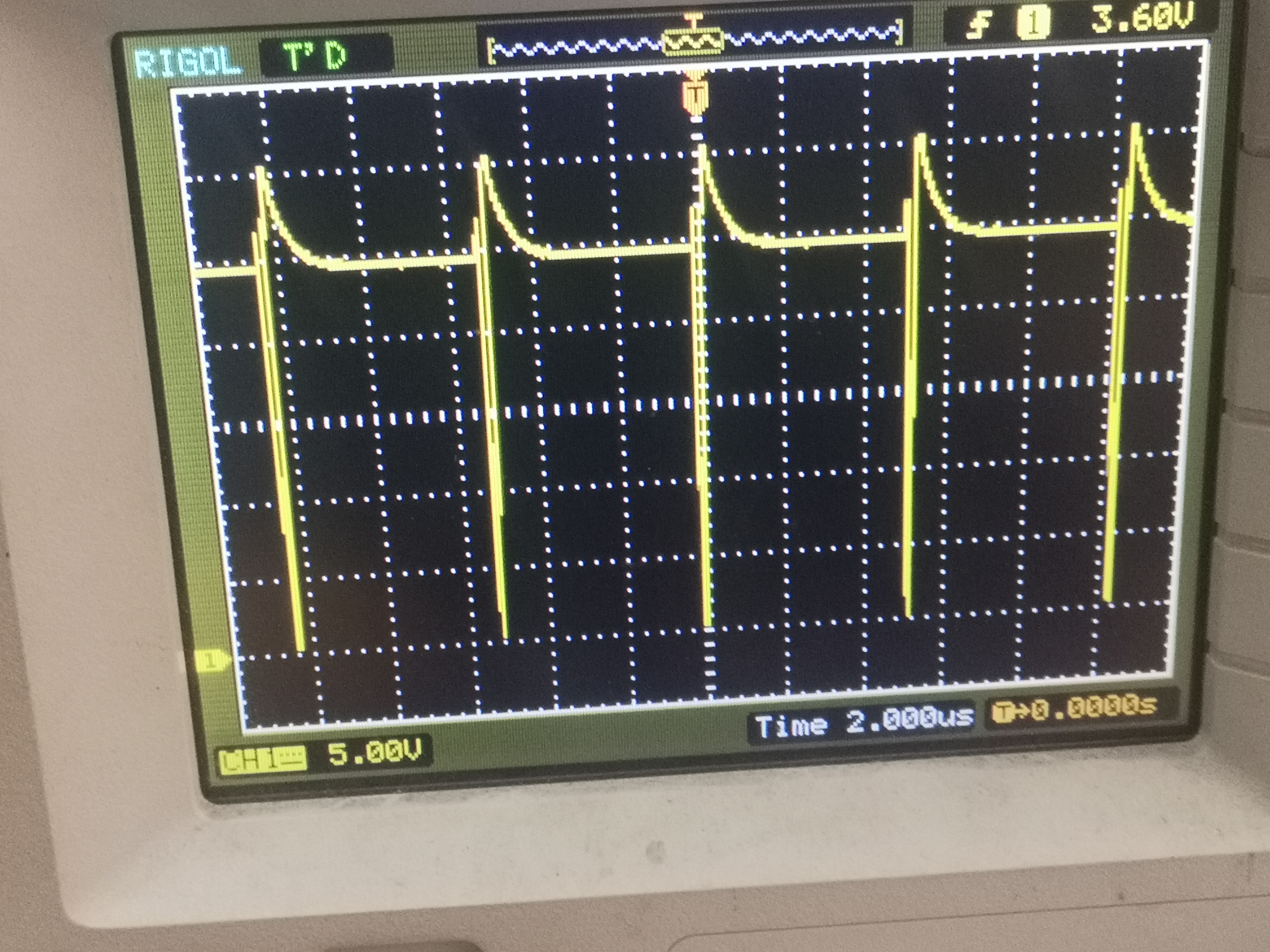

PH waveform
LODRV waveform

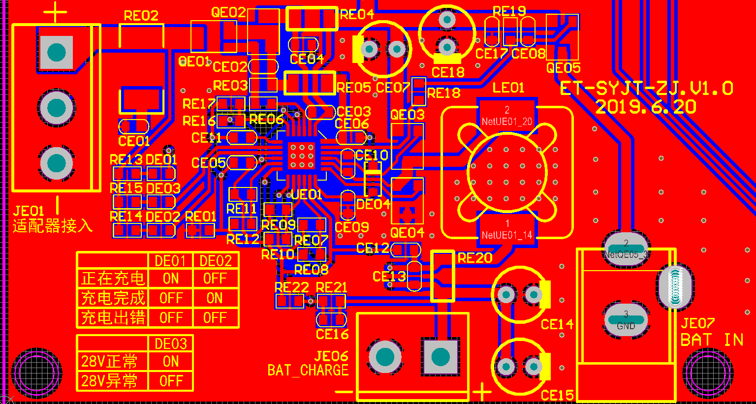

  • Hey Star,
    The first thing I will note is that you have a DGND connected to the IC. This is not correct. The charger GND pin should be connected to your power ground, as it will be processing power for the gate drivers.
    Second, I see several traces they have thermal relief type connections, but this is likely creating more impedance and may be contributing to higher power loss.
    I do not have any insight into your MOSFETs or your inductor, but I would compare those against the EVM components in terms of DCR, Coss, Ciss, Rdson to get a better idea of the potential increase in power loss.
    From your layout picture, I cannot tell what your ground layer looks like. Do have an image of the second layer?
    Joel H
  • Hey Star,
    Any update on this? If you have resolved your issue, we will close this thread.
    Joel H
