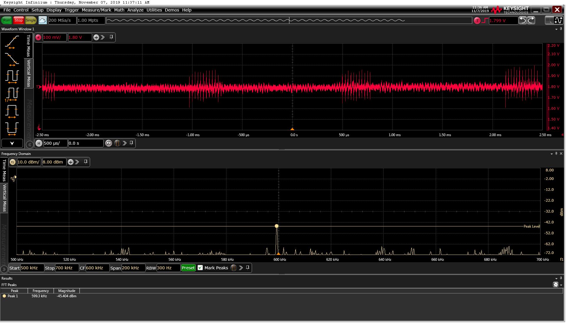

My customer are using the TPS54824RNV DC-DC Switching power supply on their new Power Board which includes few DC-DC power supplies (Switching P.S and LDOs) .
The problem (in one of the Power supplies) that there is noise with DC-DC Switching Frequency (600 KHz) on the Load card which is sensitive to noise.
When they drive the 1.8V to the load using LDO instead od the Switching Power Supply everything is ok.
Please review the below schematic picture and see if everything is ok or suggest them what can be done in order to eliminate/reduce the noise.
Note: The current consumption of the Load is very small and is about 0.5 Amp
Shlomi

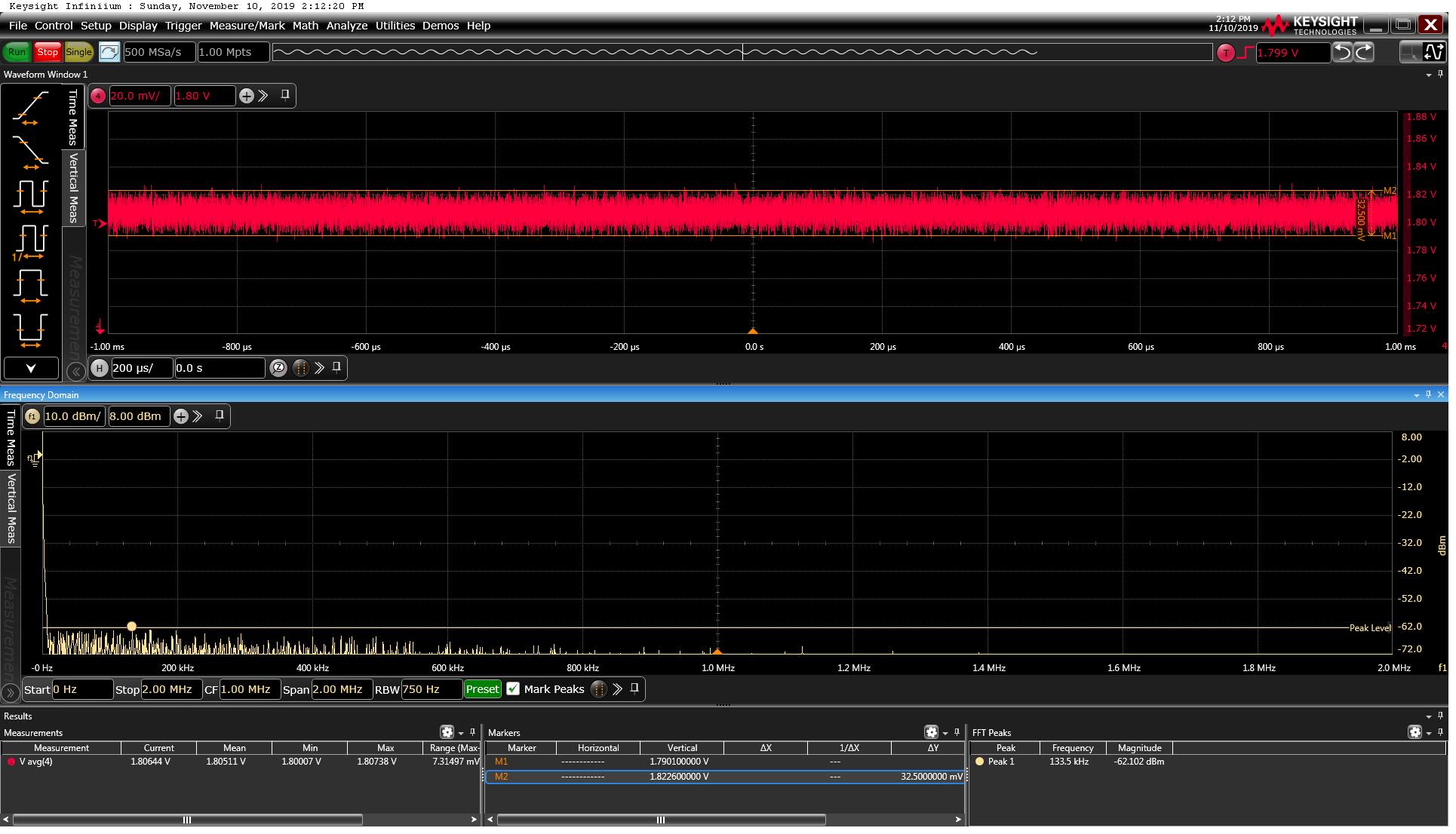

    My customer made some test in the Lab and they got the following results:
    Using the original 1.2uH inductor and switching frequency of 600kHz:
    The ripple is high and with noise
    There is noise on the 600KHz frequency of about 42dbm (see attached Orig_IND_1.2uH_600Khz.jpg picture)
    Using 2.2uH inductor and switching frequency of 600kHz:
    Using 2.2uH inductor the ripple decreased drastically and the noise on the  600KHz reduced to about 52dbm (IND_2.2uH_600KHz.jpg picture)
    Using 2.2uH inductor and switching frequency of 1200kHz:
    The ripple is small and there is no noise on the switching frequency (up to 62dbm (see IND_2.2uH_1200KHz.jpg picture)
    Using 2.2uH inductor and switching frequency of 1500kHz:
    Almost Same results as on 1200KHz frequency (up to 62dbm (see IND_2.2uH_1500KHz.jpg picture)

  • Hi Shlomi,
    Glad to see increasing the inductance helps. I don't expect much difference between the two 2.2 µH inductors and both are good. The Coilcraft one may be slightly better because it has higher self resonant frequency (SRF). The SRF is related to the parasitic capacitance of the inductor and the higher the SRF, the lower the parasitic capacitance. However I think the SRF should have more of an effect at higher frequencies, higher than the fsw of the converter.
    With 12V input and 1.8V output, the maximum fsw I would recommend is ~800 kHz. This is limited by the minimum on-time of the TPS54824. If they changed to the lower current pin-to-pin TPS54424, they could increase the fsw to ~900 kHz and increase the inductance to 3.3 µH.
    I'm also very surprised to see that increasing the fsw had such a significant effect on the noise at the fsw. I was expecting to still see a spike at the fsw of the converter. Where are they measuring the output voltage? On the power board near the converter or on the load board? If it is on the load board, the connection between the boards could be helping to filter the noise.
