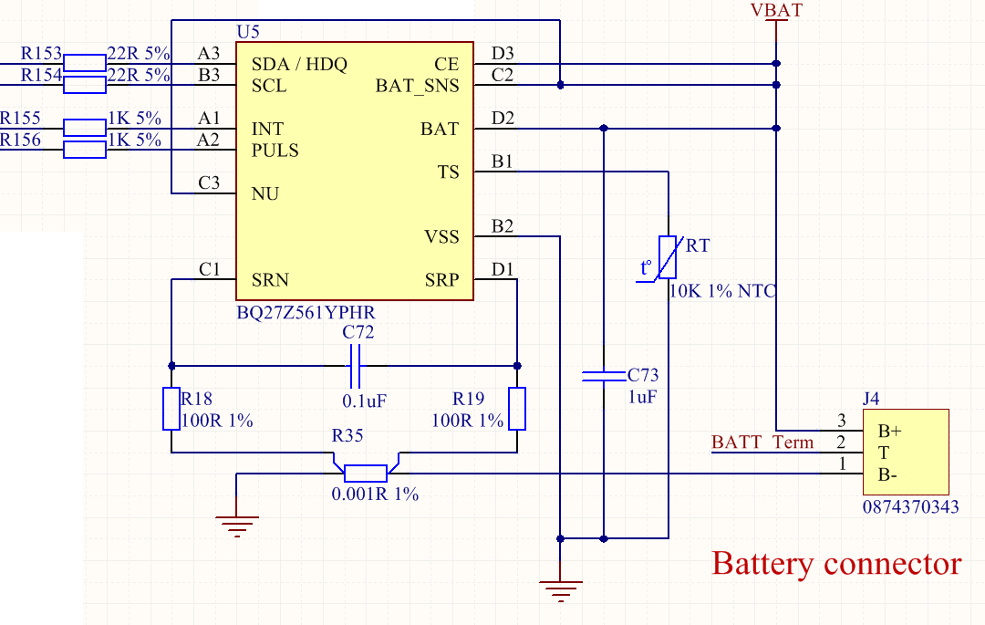

BQ27Z561: BQ27Z561 - Nu Pin connection
Part Number: BQ27Z561
We are using BQ27Z561YPHR chip. The problem is that the NU pin is connected to BAT_SENS pin on our PCBs (please see attached schematic). The question is, what are the consequences of such a mistake on the board? How can this affect the chip's performance? How much does it affect?
