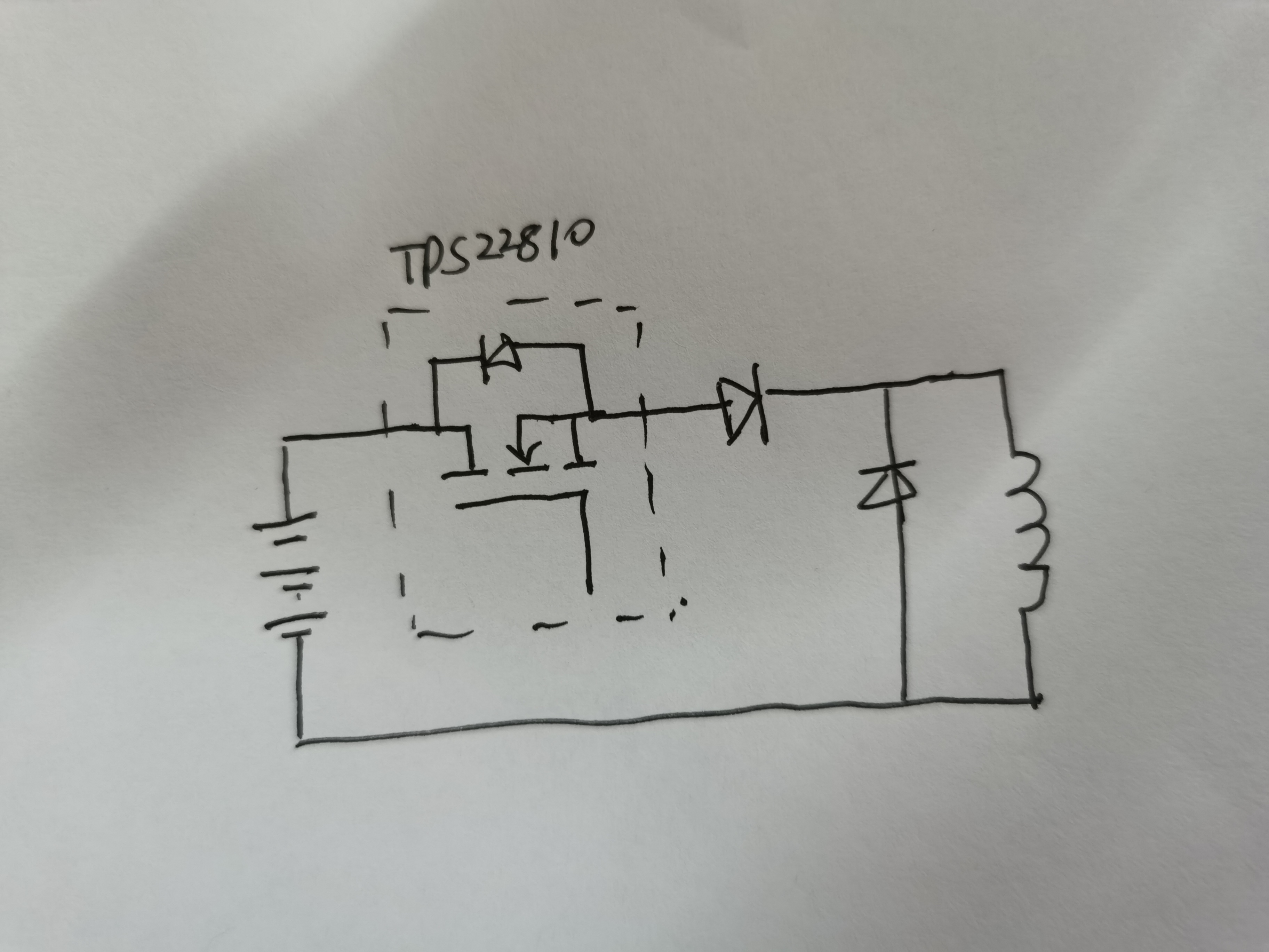

  • Hi Shreyas,
    The problem TPS22810 drive inductive loads is  when the inductive load is switched, the transients will cause current to flow backwards through the body diode of the pass FET of the TPS22810. Even with flyback diode. I will add a diode series with TPS22810. Is any other problem with this circuit?
    Best Regards
    Kevin
  • Hi Kevin,
    If you are okay with a diode drop in your circuit, I would move the diode to be between the source and the TPS22810.
    This would protect from reverse current through the FET and would also prevent reverse current from the GND plane in the case of reverse polarity (incorrectly connecting the source).
    During the turn off transient, the output rail will be pulled negative due to the inductive kickback. While the flyback diode will provide a dissipation path for the stored energy, I am slightly concerned that the voltage on the output will be pulled lower than recommended operating conditions. Out high side switch devices clamp the output voltage so that it does not reach these levels when turning off an inductive load. I do think testing may confirm if this is an issue in your situation or not.
