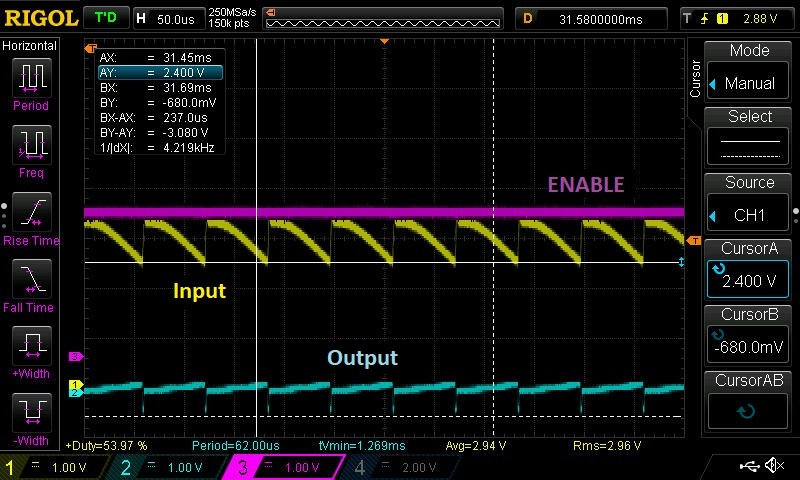

I have two problems: comparator seems to work well with very slow input (power supply controlled by hand...) or with some ramp waveform, but not always, and the other problem is Voltage drop on load switch (and overheat) when output current is higher than available (My supply is limited to 100mA, and I try to get 200mA with a load). The following snapshot was taken in this situation:
This is the schematic:
  • Hi Daniel,
    I cannot comment on the TLC393 device behavior but for TPS22810, it looks like by forcing the current to be larger than its limited value from the supply, the input starts to droop. I do not think your issue is overheating.
    The minimum recommended voltage for correct TPS22810 operation is 2.7V. It looks like the voltage is dropping below that which can cause the device to be insufficiently powered which turns off the device. The input voltage then recovers and the device is sufficiently powered again and the cycle repeats.
    I think current across the TPS22810 never is higher than rated
    I expect Vin to be lower than 2.7V sometimes, but if device is off during this period is ok for me. The problem would be if the behaviour is weird like the previous waveform.
    Does this behavior occur only when you are trying to draw more than 100mA from your supply?
    Yes, every time I put a load draining more current than available: 100mA power supply and 200mA load, 40mA power supply and 80mA load...
    The load gets is current, but with lower voltage, so the V difference drops into TPS22810, and I dont know why behaves like that.

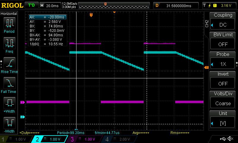

  • With 1kHz square signal at enable, TPS22810 output is allways enabled.
    With 10Hz square signal at enable, TPS22810 output is high when high part of the square, and ramp low a little when EN is low.
    Ramp almost disappears increasing the load (some mA), but increases again with frequency. I have CT and QOD floating, any other adjust can be better?
    Maybe TPS22810 is not the best suited for this quick switching job?
    Attending to the TPS22810 datasheet page 7 (Switching Characteristics), switching frequency varies from 189uS (5,29kHz) and 524uS (1,9kHz).

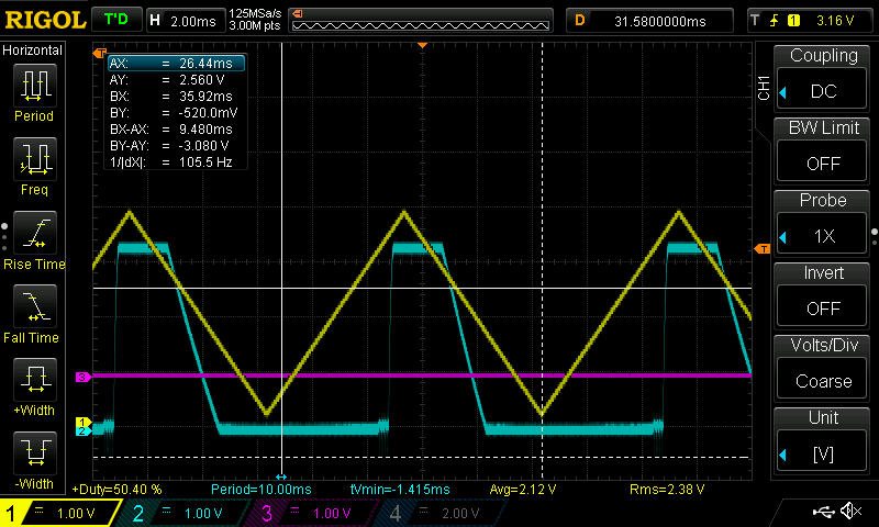

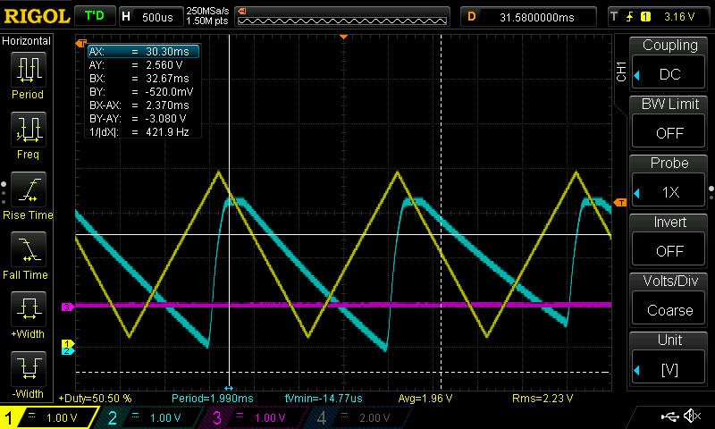

  • After adding some capacitor to improve the stability I've got this waveforms:
    100Hz enable ramp waveform (yellow), output (cyan)
    500Hz enable ramp waveform (yellow), output (cyan)
    Seems like TPS22810 is not able to do this high speed switching job successfully.
