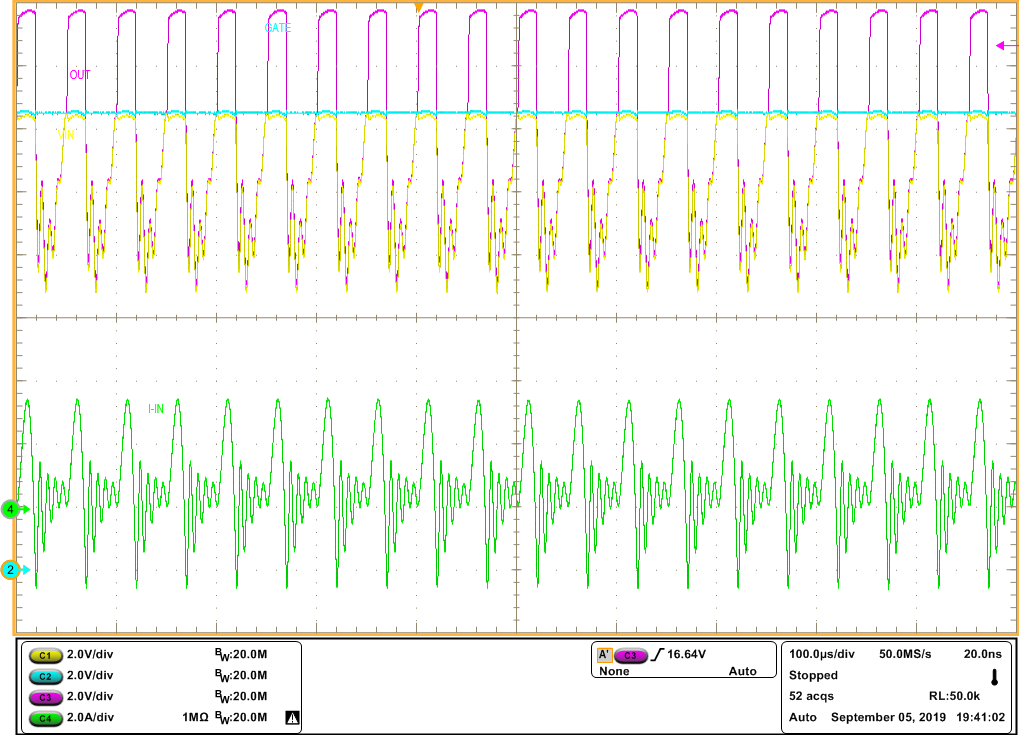

Hi team,
If LM74700 used for battery input reverse protection , what phenomenon during " ISO16750-2 4.4 Superimposed alternating voltage "
test ? Does LM74700 turn off external MOSFET due to reverse current is triggered ? please share the waveform if you did this test ever.
