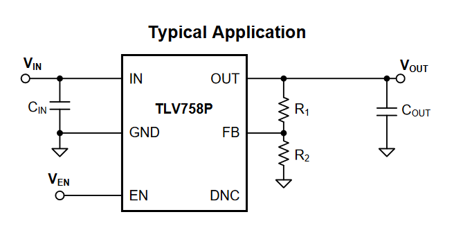

I'd like to ask Vout accurancy of TLV75801PDRVR.
I'm introducing TLV75801PDRVR for customer.
I know this device doesn't have fixed output.
Vout is 1.5v. (required in 1.4v~1.65v.)
Do you have any solution for this accuracy?

    Below I will describe an option of R1 and R2 resistors for the setpoint.
    The other parameters which fit in the +/- 8.2% tolerance window are in the datasheet.
    These include steady state parameters (line regulation, load regulation) as well as transient conditions (line transient and load transient).
    Let's set the upper resistor R1 to 24k and R2 to 13.7k.

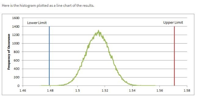

    Let's run a 100,000 monte carlo analysis on the output and plot the +/- 3 sigma values.
    Here are the results:
    Vout Average: 1.514704V
    Vout Standard Deviation: 8.838mV
    Vout 3 sigma: 8.838m*3 = 26.514mV
    Vout Nominal Desired: 1.525V
    Set the limit lines to be +/- 3% of the nominal desired value.
    Lower limit: 1.525 * 97% = 1.47925V
    Upper limit: 1.525*1.03 = 1.57075V
    Here is the histogram plotted as a line chart of the results.

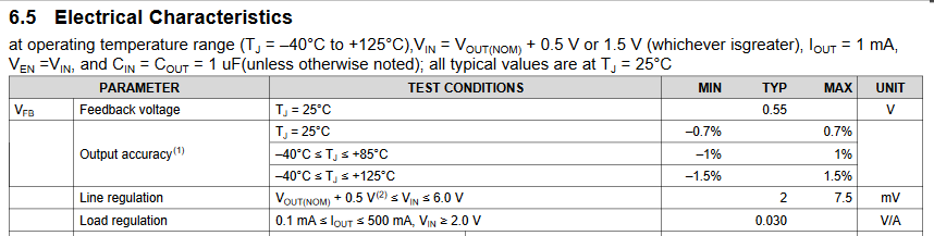

    So at exactly 95C it will only get better as the Vref tolerance will be closer to +1% than +1.5% on the high end.
    The datasheet lists Vref tolerance at 25C, -40C to +85C, and -40C to +125C.  There is no specific data right at 95C.
    As you can see below, the Vref test data was collected with the following conditions. Transients are not included (line transient, load transient), load regulation is not included (Iout is only 1mA), and line regulation is not included.  So you should add those in to your calculations.

    The output voltage regulation variation (±1.5%) was collected with the following conditions. Transients are not included (line transient, load transient), load regulation is not included (Iout is only 1mA), and line regulation is not included.  So you should add those in to your calculations.

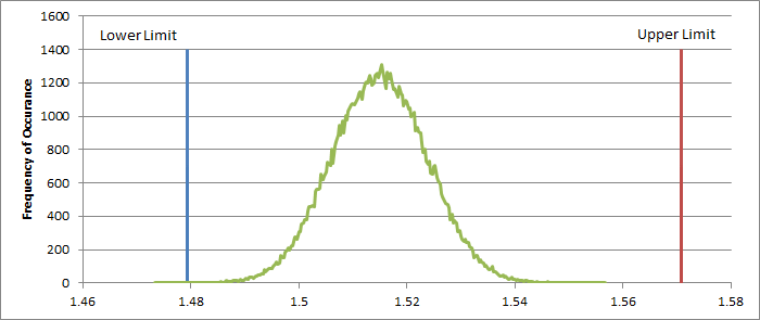

    Unfortunately limiting the temperature range to 95C will not reduce the amount of drift the LDO's output will experience. This is because the temperature drift of an LDO is dominated by the temp drift of the reference and in general bandgap references tend to reach their highest voltage somewhere in the range of 65C-85C. So the worst case drift will almost always be from -40C to ~75C, and temperatures higher than ~75C will actually show better drift performance.
    So, since the customer's temperature range still includes 75C the results of the analysis that Stephen did still remains the same.

    could you tell me what temperature range we used to get below histogram ? (-40~125℃?)
  • Hi Masa,
    This histogram does cover the -40C to 125C temp range, but recall that the bandgap/feedback temp drift reaches it's peak close to 75C so the temperature range of -40C to 75C has the same maximum drift as the range of -40C to 125C.
