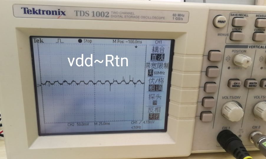

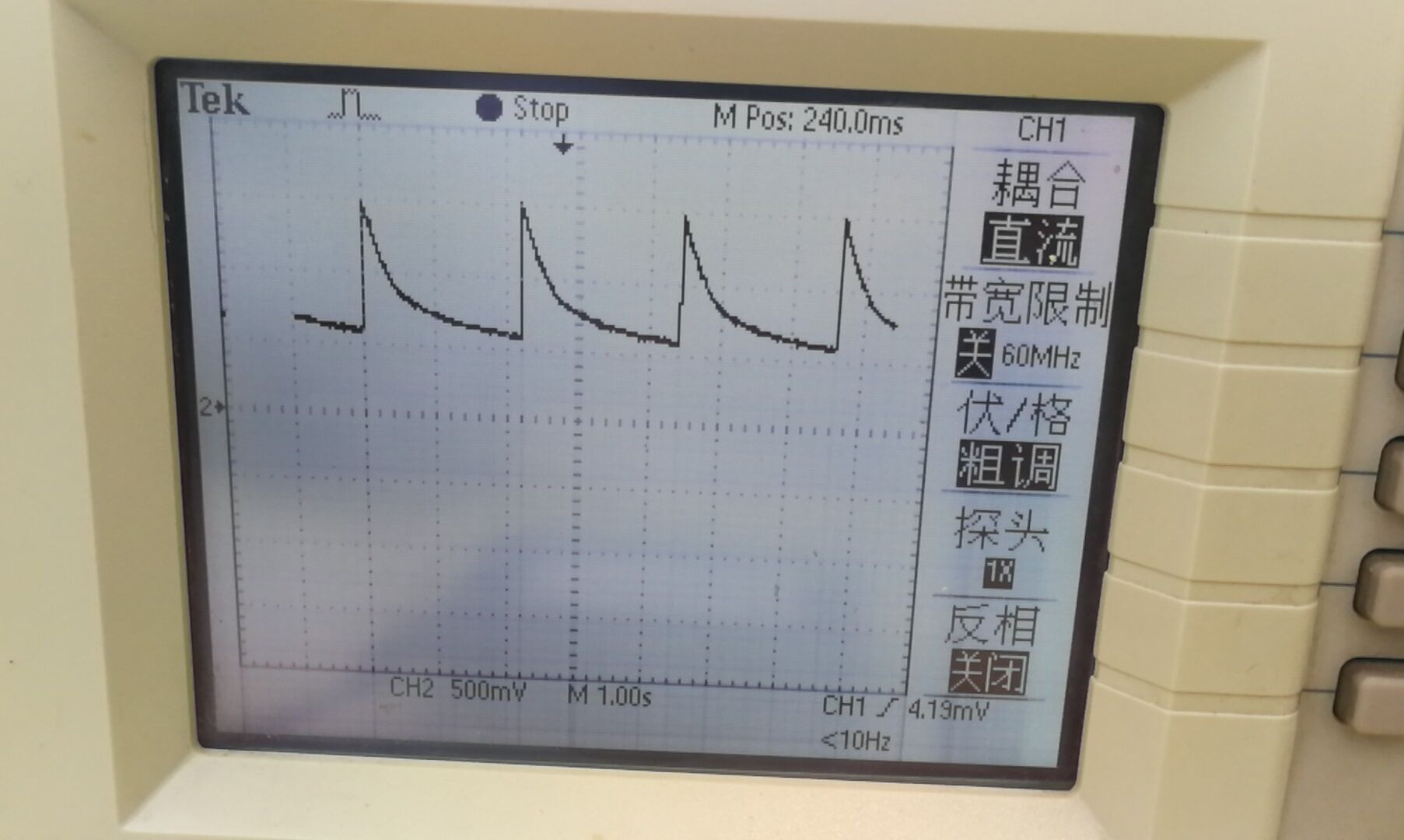

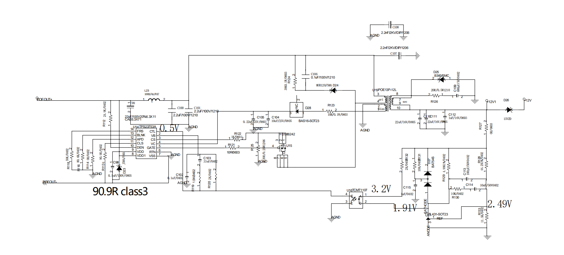

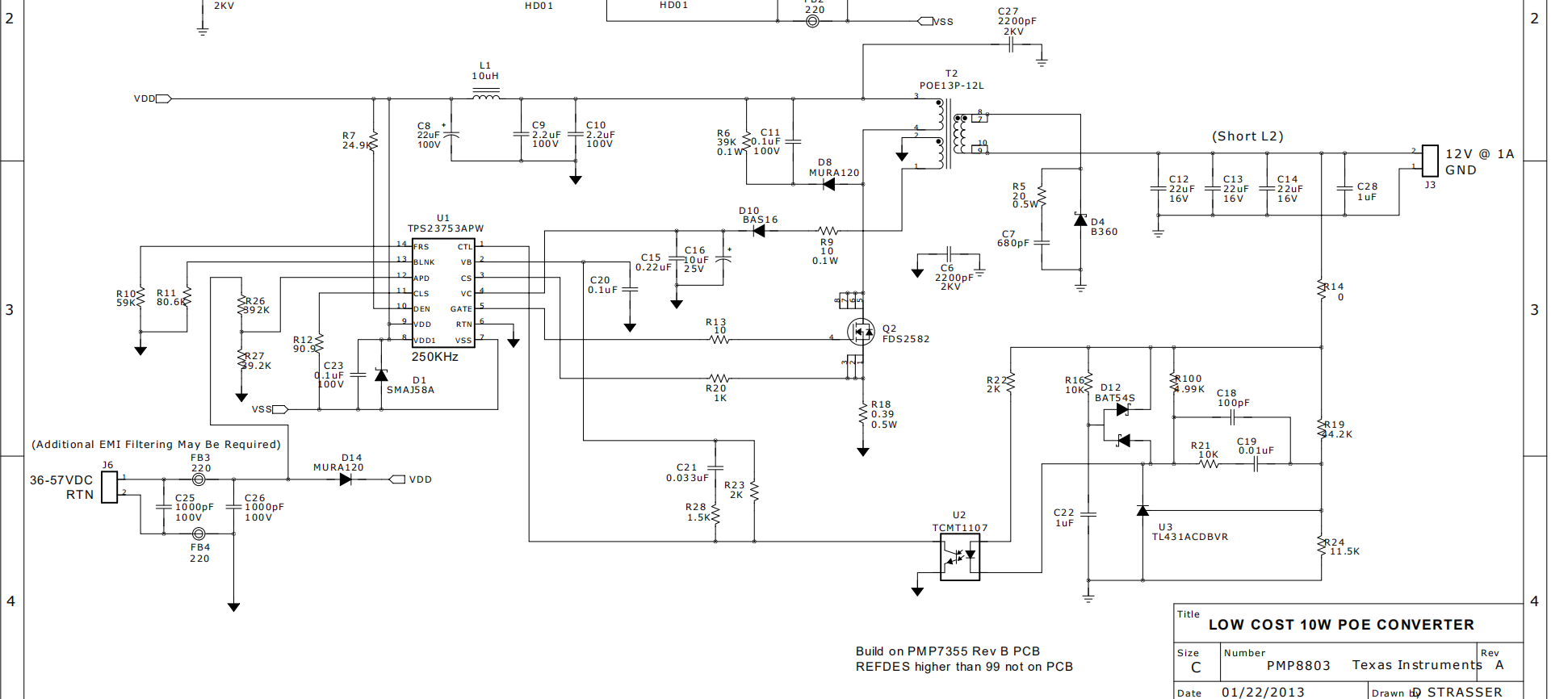

  As a  freshman,i copied from the 12V/1A demo as the attachment 1 and the attachment 2 is my design.I have a problem about the output of TPS23753A ,i have test as following:
1. Add DC24V at poeout+ and poeout- ,can get a dc12V at D26.
2. Add a Non-standard PSE equipment ---output DC48V/0.45A , also can get a dc12V at D26.
3.Add a standard PSE equipment--such as  TP-POE150S,this one can support class0-3,IEEE802.3af. There's no single at D26 ,Then the POEOUT+ and POEOUT- has no voltage,maybe it disabled detect the PD。
How can i do to get a steady voltage?It confused me several days。
this attachment is the one i referenced
my design diagram,i cant get  any voltage at D26 when use a PSE 。
