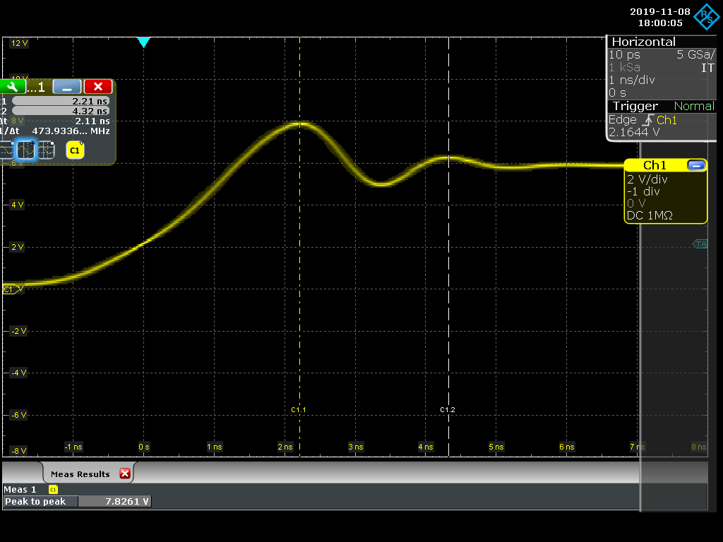

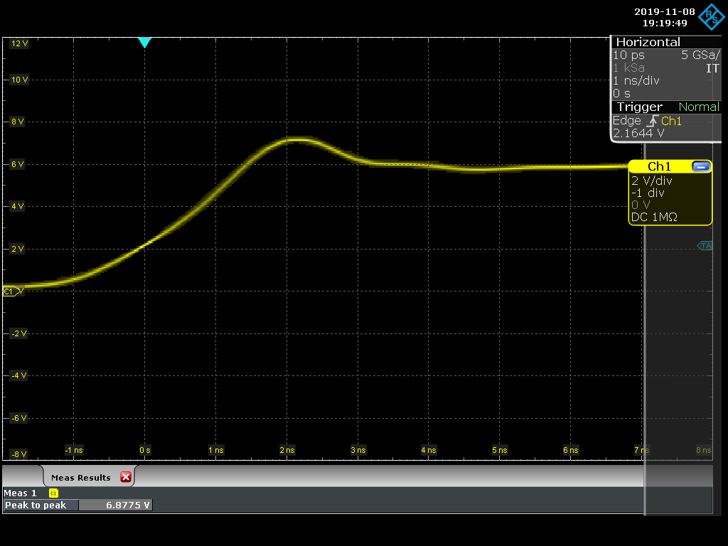

  • Hi Kato-san,
    I recommend 180 pF + 3.6 Ω on L2. This damped the oscillations and reduced the overshoot by half. Note, this was for conditions you mentioned in your previous thread: Vin = 4 V, Vout = 5 V, Iout = 1 A, and valid for the EVM.
    Before:
    After:
    Milos
  • Hi Milos-san,
    Sorry for overlooking your post.
    I would like to confirm just in case, but are these monitored waveforms for the L2 node ?

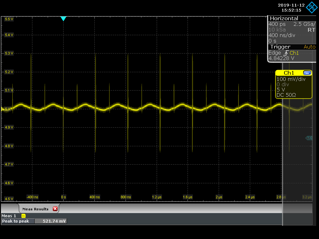

    If yes, the purpose is to reduce the ripple voltage of the output voltage VOUT, so please provide a screenshot of the output voltage VOUT.
    Kato

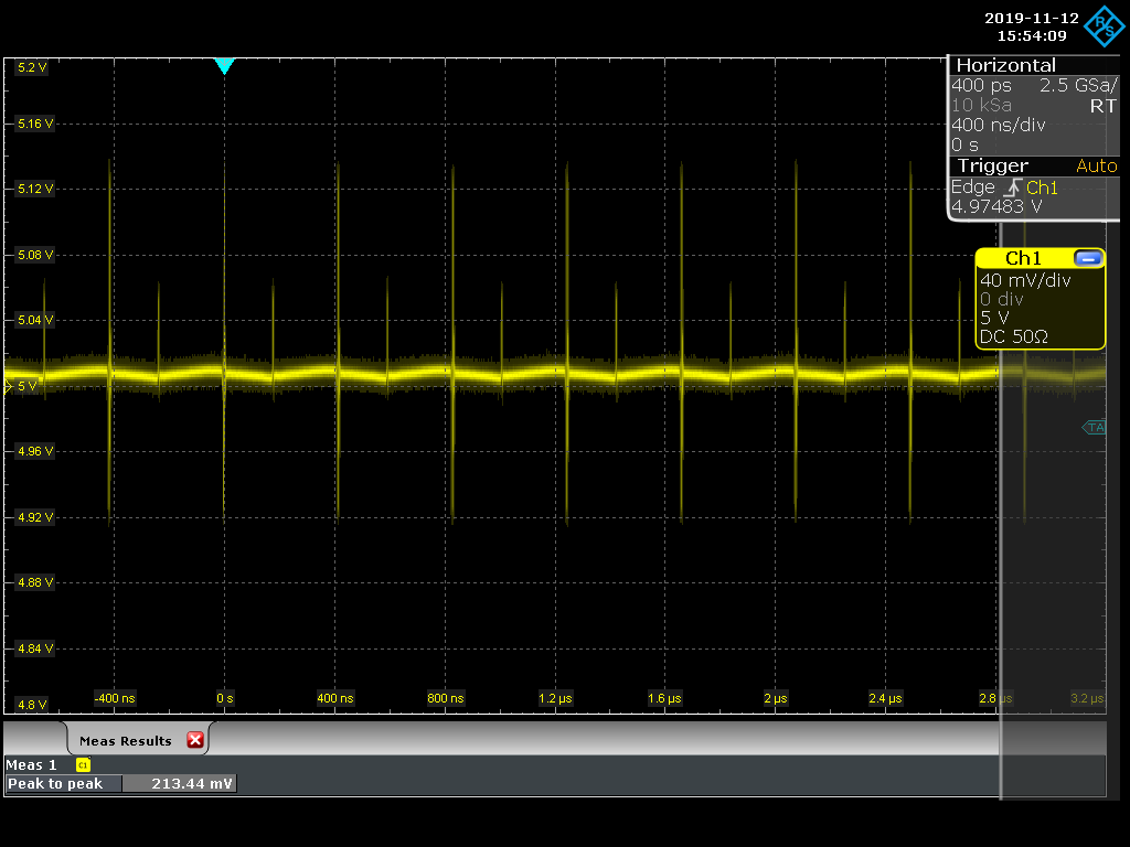

  • Hi Kato-san,
    Here is the output ripple:
    Measured on C4, with a 1-GHz active differential probe, without bandwidth limiting:
    Measured on C7:

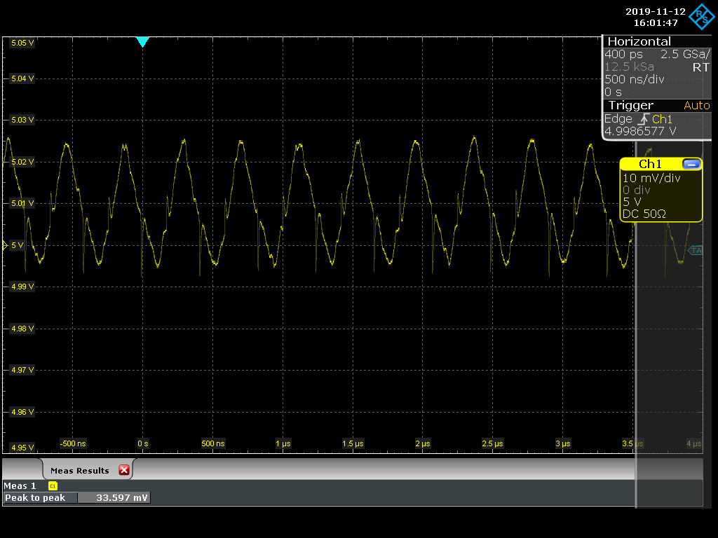

    These spikes are very short (ns or so) and are difficult to get rid off when measuring with full bandwidth, since some part is due to pickup by the measurement loop of the probe tip. It can be reduced by placing small (few nF) high frequency capacitor as close as possible to VOUT. Normally these spikes can be neglected, and the output voltage observed using the 20-MHz filter is:
