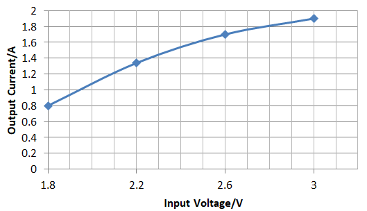

■ TPS61030
・ Characteristics of input voltage vs Maximum Output current @ Vout = 4.5V
      In other words, I need figure1 / figure2 at Vout = 4.5v version in the datasheet.

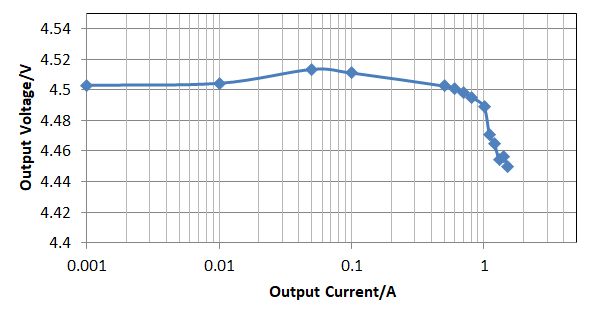

・ Output Current vs Output Voltage @ Vout = 4.5V
       Vout = 4.5V version of Figure9

  • Hi Shidara,
    OK. I can provide you the graph. What's the input voltage range of customer's application? Please tell me it so that I can do the test.
  • Hi Zack-san
    Thank you so much for your strong support.
    The customer use CR-123 for battery so please think the input voltage range from 1.8V to 3V.
    Shidara
  • Hi Shidara,
    Below is the maximum output current vs input voltage when Vout=4.5V.
    Below Vout VS output current curve when Vin=2.4V
    Hope that helps!
