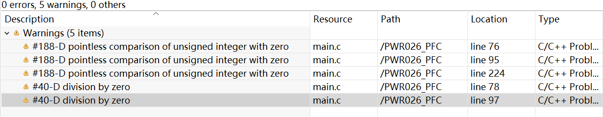

If VAC_MIN_OFF and VAC_MIN_ON both update to 0,there will be warnings like following.
The reason I suggest to set both VAC_MIN_OFF and VAC_MIN_ON to 0 is because if these two value too close, there may be not enough hysteresis. Now you can change them to whatever you want.
