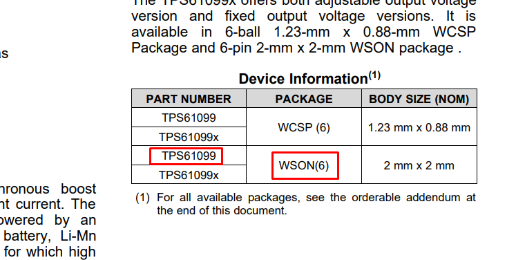

    2º. Besides, I have another question related to TPS61099. According to the datasheet I can see there is WSON package for the TPS61099:
    But I can't find the part number for this IC. Would you mind helping me?
    Best regards.
  • Hi Oscar,
    sorry for the late.
    1. if the TPS61099 is set to 2.5V. the device would operates at down mode if input is typical 0.5V higher. the efficiency at down mode is not good. that is why I hesitate to suggest setting the output to 2.5V.
    the issue relates to this device is that the power supply can't be oscillate at UVLO range, which is between 0.5V~0.7V.
    2. unfortunately, the adjustable SON TPS61099 is not available right now.
