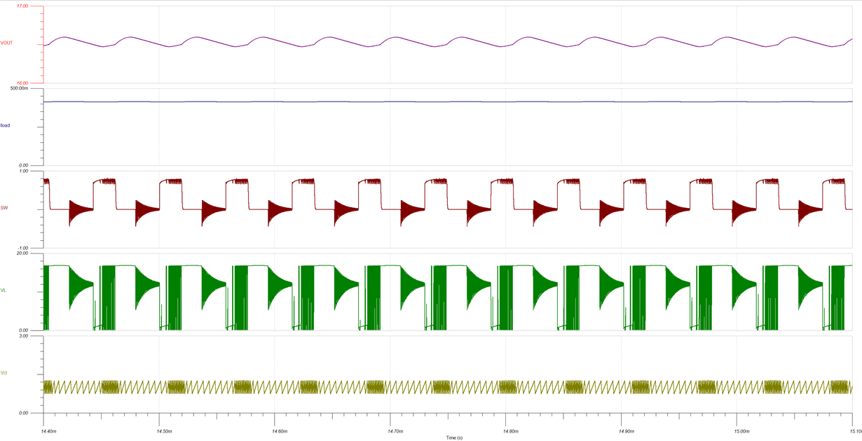

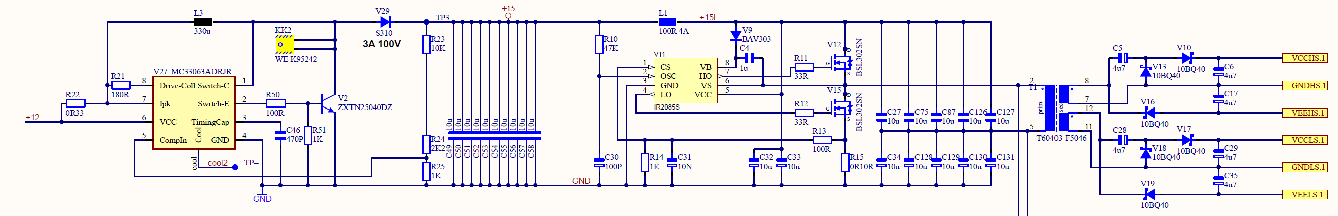

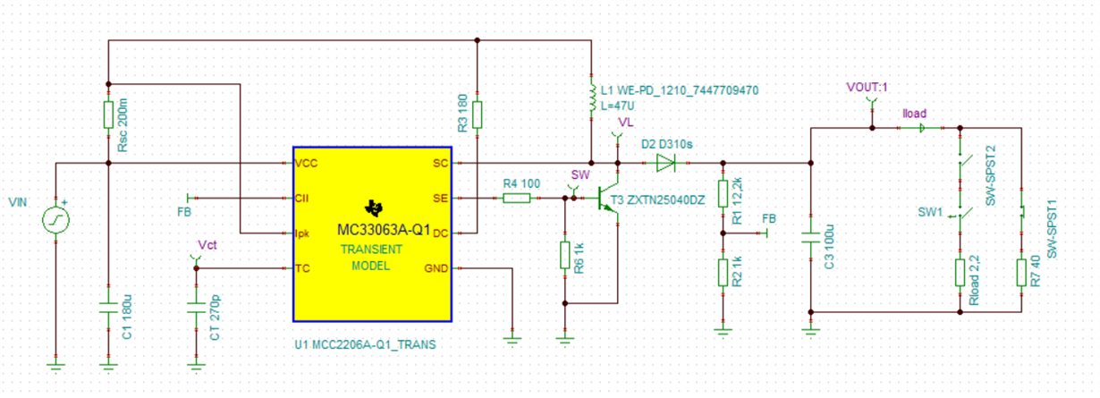

I simulatet a stepup converter.
I have already set up the circuit and received metrologically similar / same signals
But I think there is something going wrong because the signals look bad.
At first the simulation shematic

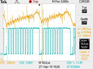

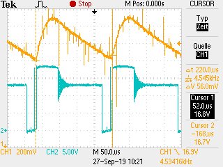

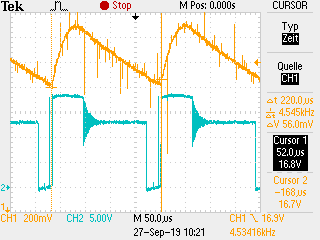

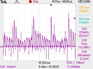

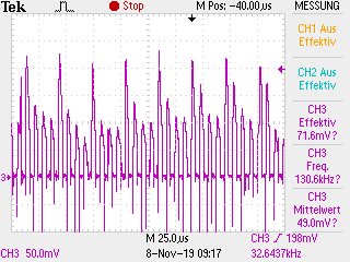

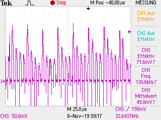

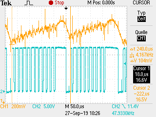

Now the meassured signals:
I cant find there a fix frequenzy, more some swinging signals.
In application normaly we have constant current of 50 to 100mA and some Peak of 21A für 1,2µs when the IGBTs are switching. They swithing whith 4, 8 or 16kHz.
for calculation:
worst case at 16kHz 62,5µs/1,2µs * 21A = ~400mA
400 +50 mA =450mA
whith an output of 16V, an input of 12V and a minimal sw-freq. 55kHz I've calculate:
Ton/Toff 0,60
Ton+Toff 1,82E-05 s
Toff 1,13E-05 s
Ton 6,83E-06 s
Ct 2,73E-10 F
Ipk 1,44 A
Rsc 0,208
Lmin 4,74E-05 H
Cout 2,77E-04 F
So I hope you can helb me.
