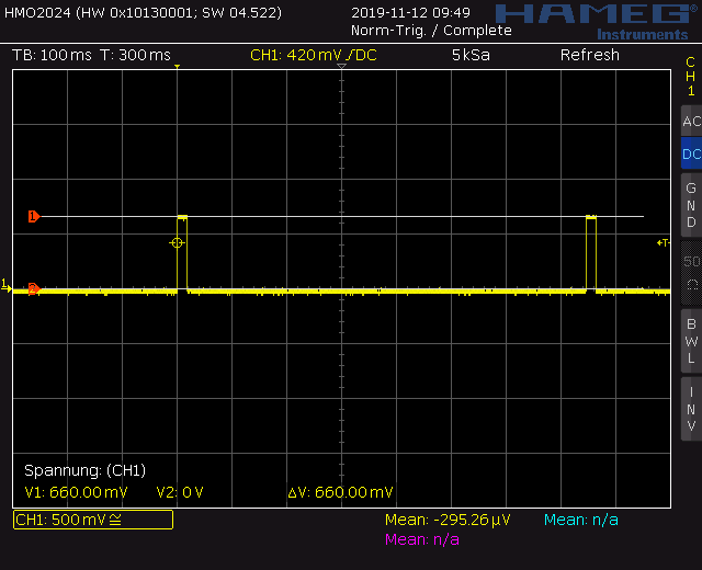

  • Hi, Martin
        Can you measure the voltage at the TS1 pin and GND with NTC removed with oscilloscope, I think that waveform could be helpful to identify why such diversity temperatures are reported in those failed devices.
  • With connected NTC:
    Without NTC: (^= -53.8°C)
    Seems not very special.
  • Martin
        I also made measurement to TS1 pin with oscilloscope, when the oscilloscope is attached to the pin, the reading is stable, -53.1C. I only observed -70C~75C or -5xc randomly when I remove the probe. This indicates the voltage at the input of TSx is not stable when NTC is not connected.
       Also, per datasheet, the max input for ADC is 0.8xREG, the voltage for the peak of NTC pulse I measured on the scope is 1.7v, it is already out of the input range of the ADC, the output accuracy is unspecified. So the value is not reliable.
